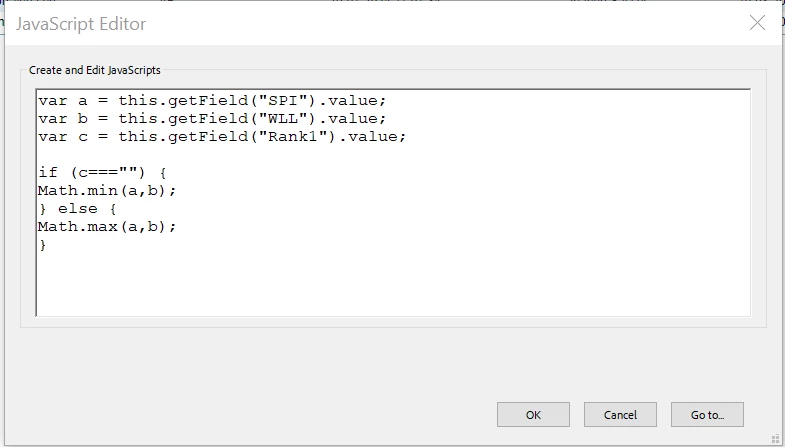

Correct answer Nesa Nurani
Here's what the Java Script Editor for the field looks like
You also need to assign min and max to event field as pointed by  @PDF Automation Station
October 9, 2024
this.getField("Field1") calls the field object.  You need to call the value of the field object like this:
this.getField("Field1").value
Nesa Nurani
October 9, 2024
Use like this:
var a = this.getField("Field1").value;
var b = this.getField("Field2").value;
var c = this.getField("Field3").value;
if (c==="") {
Math.min(a,b);
} else {
Math.max(a,b);
if you use like this:
var a = this.getField("Field1");
var b = this.getField("Field2");
var c = this.getField("Field3");
then need to add values like this:
if (c.value==="") {
Math.min(a.value,b.value);
} else {
Math.max(a.value,b.value);

Is making Rank1 a value somehow negating that it's blank in javascript?
October 9, 2024
