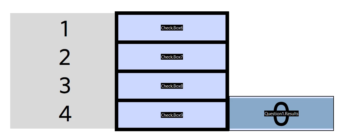

I am finishing up a project, and I have some questions that require only one answer, but currently all the checkboxes can be checked.
I am wondering if someone can give me some help as to what mouse up code I need to use so that only one checkbox can be checked per question? '
I am guessing this can be achieved with a Mouse up code, but I am completely ignorant in Java.
Thank you so much for your time.

Read this article:
https://www.pdfscripting.com/public/Checkboxes-and-Radio-Buttons.cfm
The solution is to give all the fields the same name, but different export values. No JavaScript needed.
Thom Parker - Software Developer at PDFScriptingUse the Acrobat JavaScript Reference early and often
December 13, 2022
Will this prevent the other checkboxes being checked? Will they all show up as checked?
December 13, 2022
I would suggest you read the article and give my suggestion a try. See what happens.
Sorry I ever doubted you Thom!
It works flawlessly!!!
