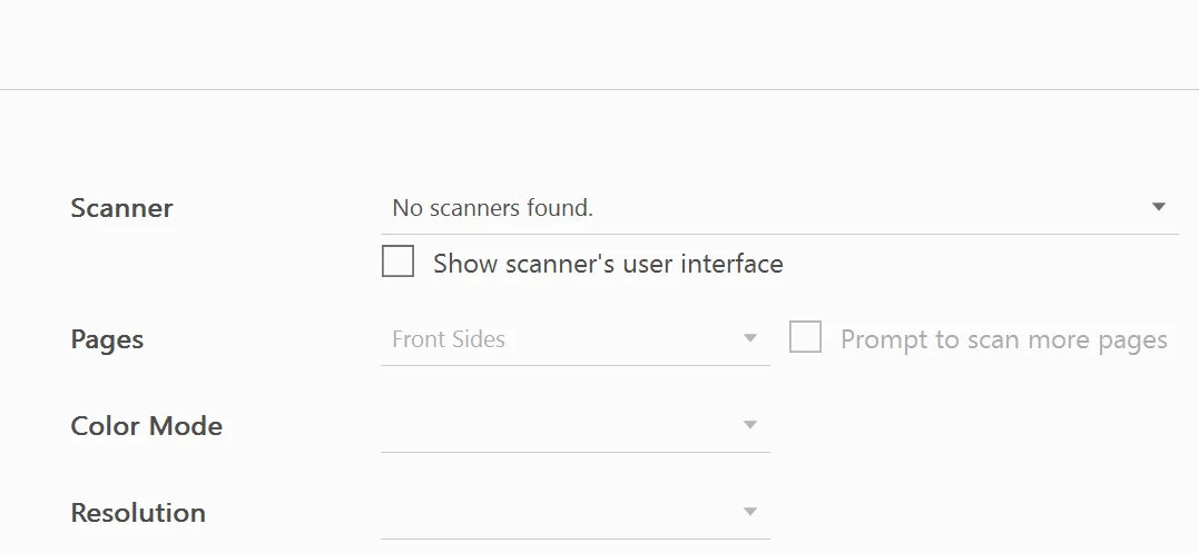

Was your question ever answered?  I came here looking for the same answer.  Just got a rebuild on a work computer and the prompt didn't come up.  Found out how to fix it on mine (Acrobat Pro DC).  File/Create/PDF From Scanner.  On the screen that comes up, it says Scan Using My Custom Settings.  Next to it is a gear symbol; click on that and the checkbox is there.  Hope this helps.

From how long you have been experiencing this issue or when did you notice it? Also, are you referring to the checkbox shown in the screenshot showing below? After checking this, reboot your Acrobat once.
As per the Acrobat's internal settings, this is the only option that needs to be checked to get the prompt. You might need to check if t here is an option under the Scanner properties by going to system's Control Panel>Devices & Printers.
