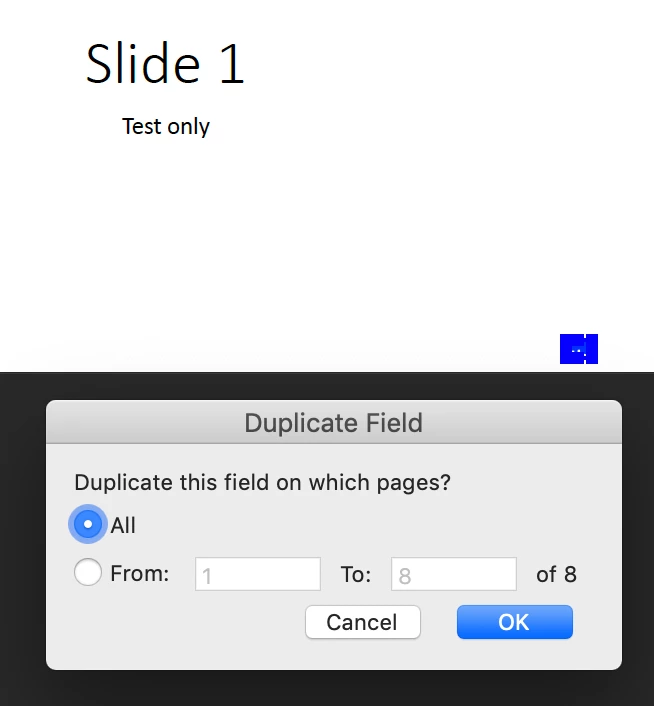

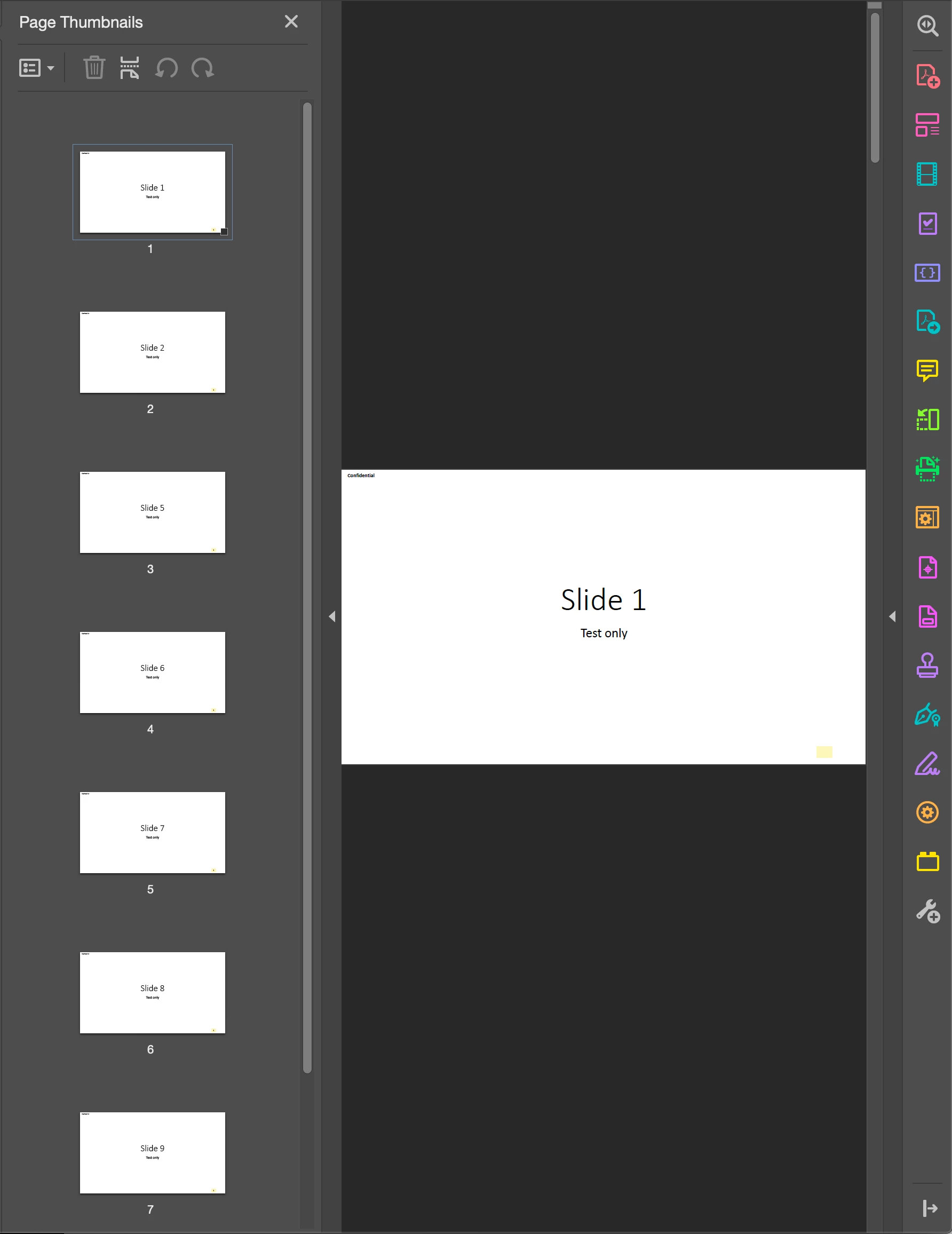

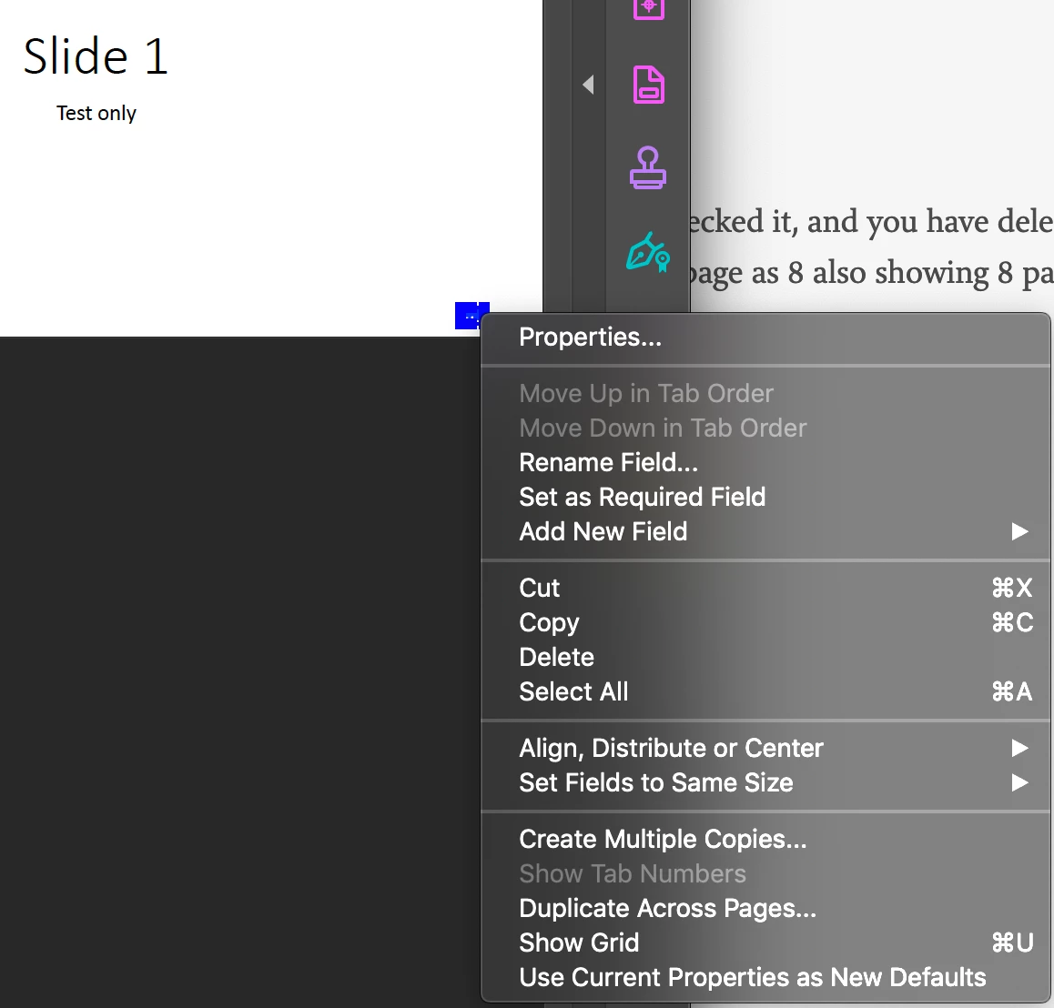

It is not possible to modify the Acrobat text, but here is a tip you can do:
Create a "thePage" field on the first page under the page number (here I did it in yellow to show you).
Then you duplicate this field across all pages.

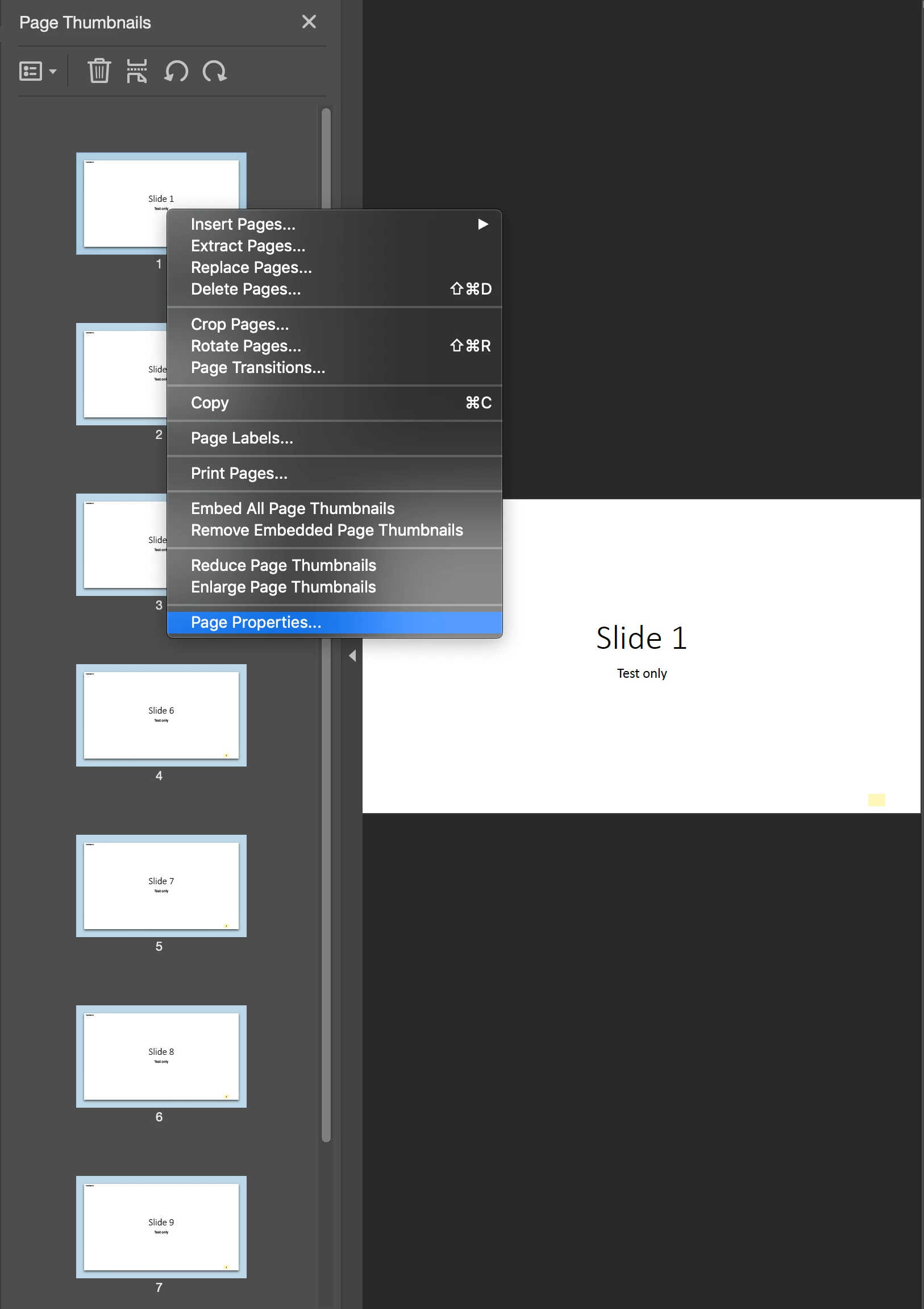

You select all thumbnails on the left and right-click "Page Properties...".

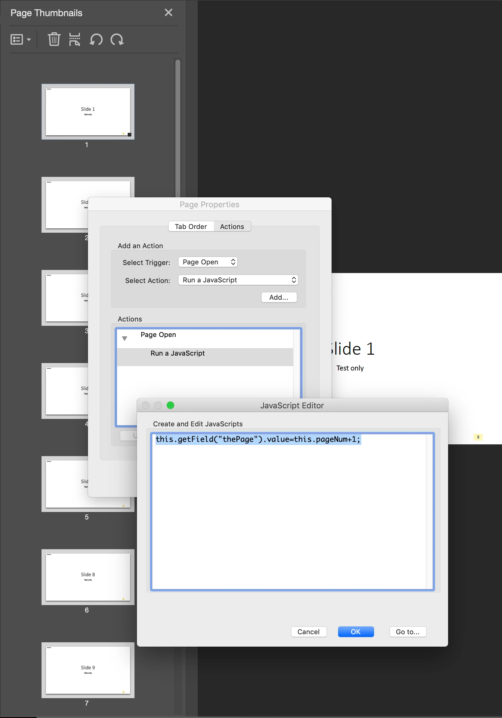

and you type
this.getField("thePage").value=this.pageNum+1;
as "Run a JavaScript" action for Page Open.
Now this will give you the real page even if you delete some page!
