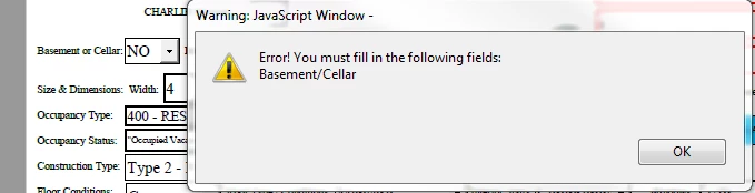

try67Correct answer
Aug 1, 2018 8:36 PM UTC
Thanks for the response.
I am not entirely sure how I should go about changing the code. I have pretty much just tried to amend all of your contributions that I have seen in these forums so they fit my data. Not sure how to go about simplifying it the validation.
At least it's pretty much working except for that dropdown box I referenced above that isn't registering as having been filled in.
Thanks again.
Replace all of this:
    // check based on field type
  switch(oField.type) {
  case "button":
  // do nothing;
  break;
  case "checkbox":
  case "radiobutton":
   if(oField.value == oField.defaultValue && oField.value == "Off") {
   emptyFields.push(f.name);
   bProcess = false;
  break;
  case "combobox":
  case "listbox":
  case "text":
   if(oField.value == oField.defaultValue) {
   emptyFields.push(oField.name);
    bProcess = false;
  break;
  case "signature":
   bProcess = false;
  break;
  default:
  app.alert("Field not processed " + oField.name + " type " + oField.type, 1, 0);
   bProcess = false;
  break;
  } // end switch type;
With just this:
if (oField.valueAsString == oField.defaultValue) {
    bProcess = false;
16 replies

Your fix appears to work, with the exception of 1 dropdown field. It's a dropdown field that has a blank as the default and then a Yes or a No option for the question if there is a Basement or Cellar. I have selected No and it still gives me the pop-up that it's not filled in.
