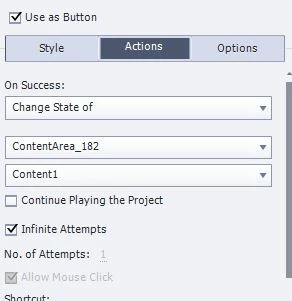

HI all, On Captivate 9 I created a state view slide with four buttons, so when the user clicks on each button, they will see different content displayed.
I want to force navigation to ensure that the user clicks on ALL 4 buttons (in whatever order), before being able to see the 'NEXT' button appear on screen that will allow them to move to the next slide.
I believe that I have to create variables and advanced actions on each button to create this logic, but how can I add additional actions on the same button? I see under 'ACTION' that all buttons already have an action to open the content of the state view when clicked:
Is there a way to add another action to the same button?  Please share instructions to help me create the logic to achieve this? Many thanks.

    You need user variables and a conditional action with two decision for each of your buttons. I posted this work flow multiple times, but it so hard to find the thread again. Another try:
    1. Create 4 variables v_one, v_two....v_four with a default value of 0; they'll be changed to 1 when the associated button is clicked.
    2. Create a conditional advanced action for each button, with two decisions:
      1. First decision 'Always' is a mimicked standard action
           IF 1 is equal to 1
               Assign v_one with 1
               Change State of ....             the action you had a this moment
      2. Second decision 'CheckVars'
        IF v_one is equal to 1 AND
             v_two is equal to 1...
                         is equal to 1
        Show Bt_Next
        Enable Bt_Next
    Create a similar action for each of the buttons, only the first decision will have to be changed (the variable and the state change).
    The button Bt_Next has to be hidden in Output to start with. Be sure to set the pausing points of the 4 buttons at the same moment,. For the Next button you can have pause at the same time or later.
