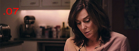

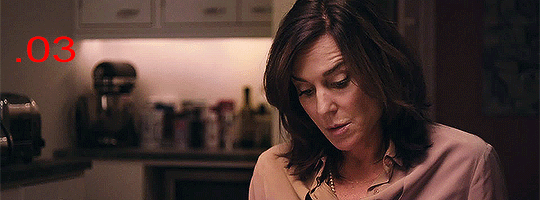

Hi, I am not having a problem here on an iMac, OS 10.13.4, with the latest version of Photoshop CC. Attached are .07 and .03 delay versions of your sample file. I followed all your steps. It sounds like you know what you are doing, but just double check that you are selecting all the frames before you change the delay so that all frames have the same delay - which you probably are.
What are you using to export - Save for Web? That's what I used. If you check everything over and nothing else works, you might try resetting your preferences.
