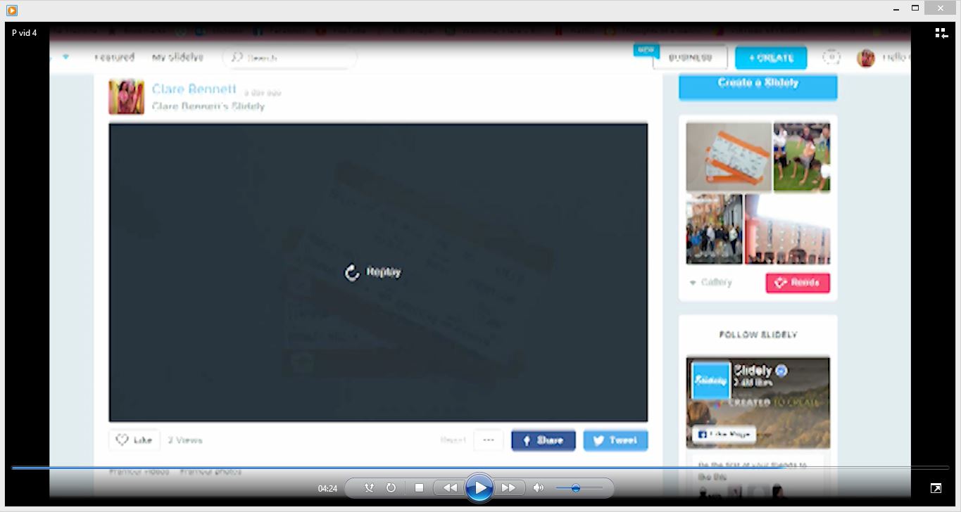

1help.JPG (the number 1 in top left of screen, usually a number between 1 and 30)
help2.JPG Export settings, preview is fine (exporting for youtube)
When I watch the export, this is at the same time as the preview panel in the export settings and all I see is this frame for a good 30 seconds (this frame I cut out of the clip too)

1.  bandicam. Make sure the footage is of constant framerate. Dont know what those green numbers are.
2.  you are trying to export your timeline from SD 4:3 (standard definition) into widescreen HD.

Dont know if this will fix it but you coould
Run your bandicam footage through HandBrake and set it to constant framerate
Choose a different sequence setting or export setting.
