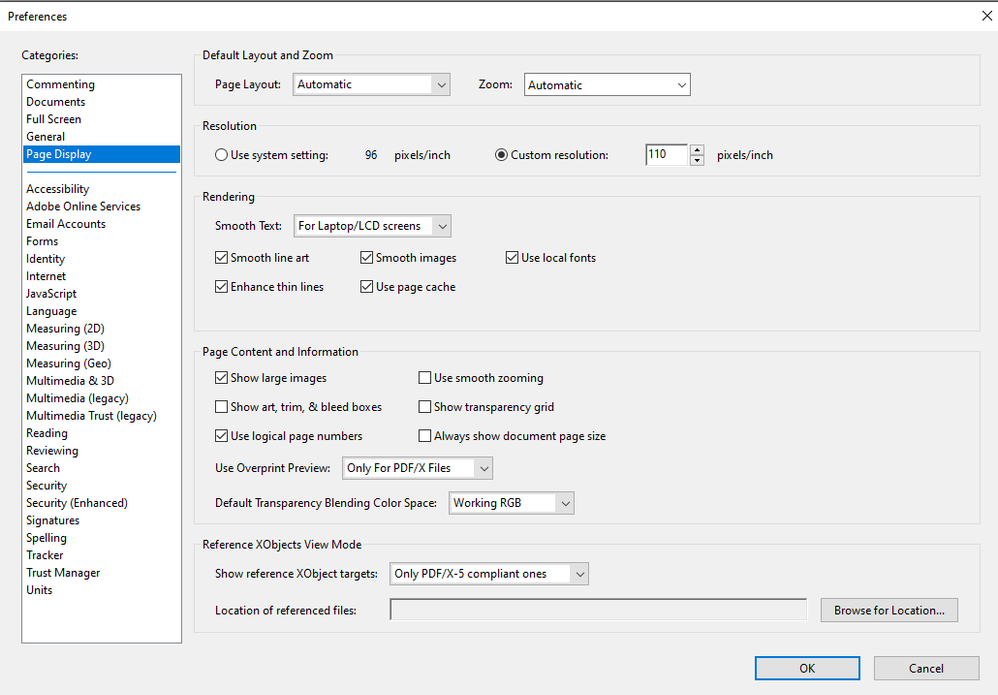

1 ACCEPTED SOLUTION
New Here ,
Apr 09, 2020 Apr 09, 2020
Oooooooohhhh!!!!!!!!!!!!!!!!!!!! i find the real solution. you can translation to solve it.
花了好长时间,终于找到了解决方法,大家可以试一试,如果成功的话来分享一下喜悦。
解决方法:编辑,首选项,页面显示,关闭使用2d图形加速。完美解决!!
解决完思考了一下,应该是我之前升级了显卡驱动导致的,大家应该也可以通过显卡降级解决这玩意。

New Here ,
hello, l have the same problem. l am a chinese, my english is not good, so i will speak it in chinese, please translate it into english, thanks.
我也有相同的问题,网上下载了不同版本的acrobat,从2018,2019,2020都试过了,会发生一样的问题,我也用清理软件完全的卸载了它,试过官方的卸载工具,也试过第三方强力卸载软件,然而都没有用。我反复装了好几次,都没能解决它,也试过修复,没用,也试过关闭增强保护,也没用。我有理由怀疑这和电脑本身有关系,我的电脑系统版本是win 10 1909家庭版。并且我发现,当我打开一文件,然后关闭它,再打开另一个文件,它依然会出现和之前一样的问题,尽管它没有同时打开两个pdf,这也许对你们解决问题有些帮助。说实话,我搞了一天的这个,都要崩溃了,中文搜索引擎上我能看到也有不少人出现了这种问题,然而全网都没有解决方法。
New Here ,

New Here ,
Apr 13, 2020 Apr 13, 2020
Thank you 木鱼! Your solution worked perfectly.
New Here ,
May 25, 2020 May 25, 2020
Thanks it helped me fix the problem!
New Here ,
Dec 02, 2021 Dec 02, 2021
!!!!我折腾了四五个小时了!试过了所有的办法!爱你啊答主!!真是个好人!我现在眼泪都要流下来了...
Community Beginner ,
Dec 16, 2021 Dec 16, 2021
Hii,vamsi here. hope ya'll doing good. so I've followed to the page that you were saying, after going there under PAGE DISPLAY i couldn't find 2d graphics acceleration. some one help me please...!Screenshot (9).png
