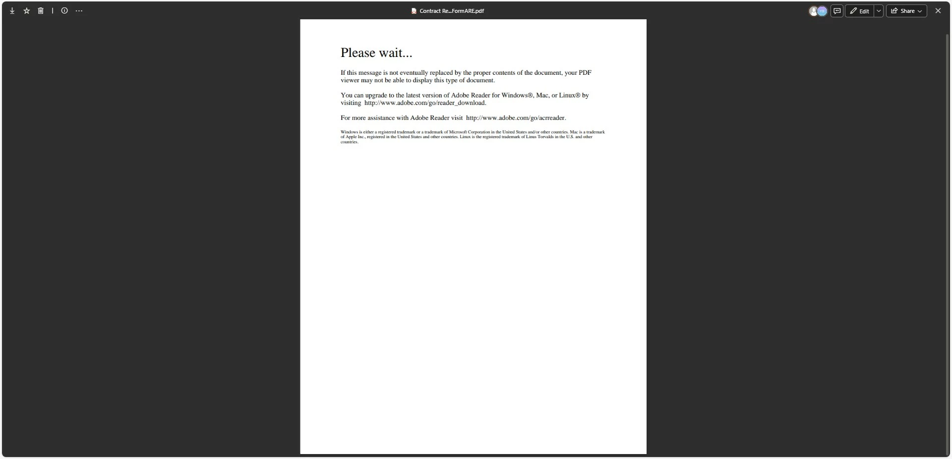

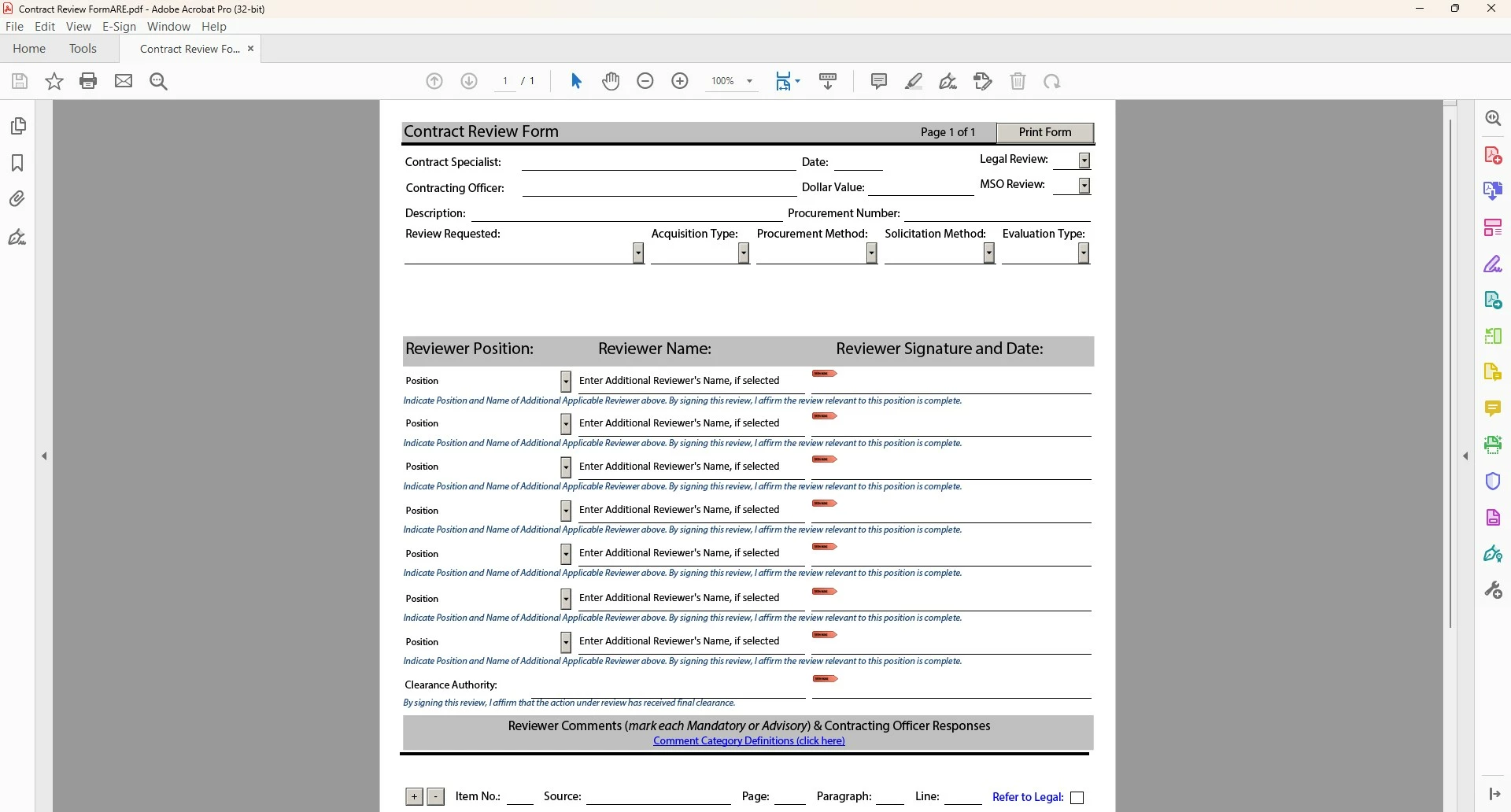

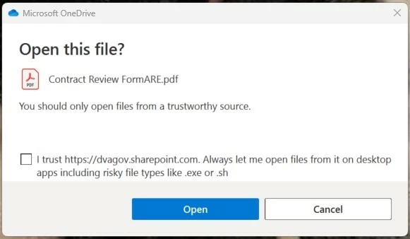

A form was created using Designer. When the form is being clicked on to open, from a publication, it opens weirdly, via the open in app. Other forms in our publications open up in Adobe without any additional steps. See attached screenshots to see how we have to open this form. We have adobe pro version 25 and this is saved with the reader extended PDF, enable more tools and fill-ins.
Would appreciate any assistance and guidance on how to get this form to open in Adobe without the edit in app method.

I looks as if you are turning to open up the Designer* form in a browser or web-based viewer. The XFA documents don't work that way--you need to download them to your harddrive and open directly in Acrobat, bypassing the browser.

Just to clarify, one of these forms opens in the browser and the other doesn't?
Your 4th screen capture shows the form opened directly in Acrobat. That isn't what you mean by opening properly, is it?
Correct, I'd like the contract review form to open up directly in adobe.

XFA document usually contains JavaScript, and can perform some operations hence the sandboxing. You can whitelisting the location in Acrobat > Preference > Security(Enhanced) and that should help.
Also, you need Acrobat to open XFA Form aka Designer form: https://adobe.ly/4n8xKtQ
