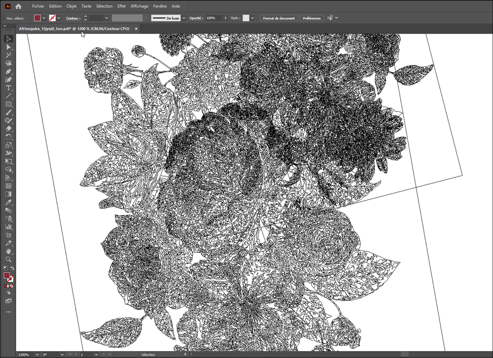

Now I can tell you why: the flower bouquet is not a pixel image, it's made of billions vectors, see it below when "Edited with Illustrator".
Pixels can be downsampled and compressed using a lossy format (JPEG).
Vectors can only be compressed without loss (ZIP) and therefore there is a low limit.
So, in InDesign you should replace this vector image by a pixel image before exporting to PDF.

I've analysed the file. You say it has only one image. But no, it has no images at all, and this is the key. Zoom in on the flowers in Acrobat. And zoom in again. And again. The detail is exquisite. This is an extraordinary vector drawing. Lovely, but nothing can be done to shrink it. In controlling the size of a PDF, you need to control what goes into it. In the worst case (picture chosen by someone who cannot be overruled), you can rasterise the picture to an image.
Once you have an image you can compress it. Compressing images is exactly the same as reducing quality - that's what it means. You can only decide on your threshold of acceptable quality vs. size; or use less of them.

The content streams comes from the flowers.
