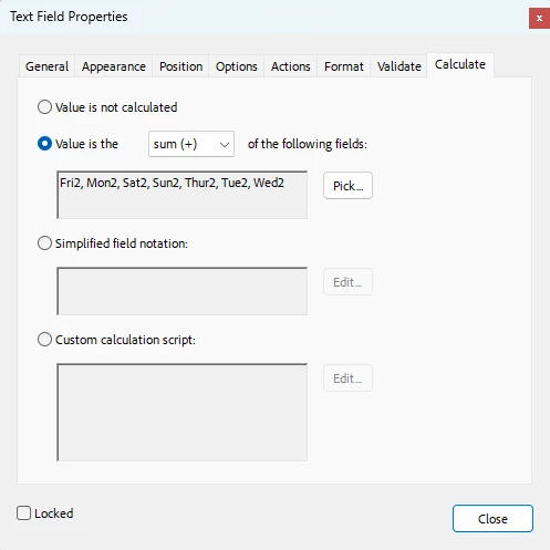

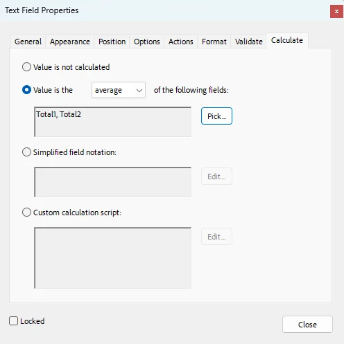

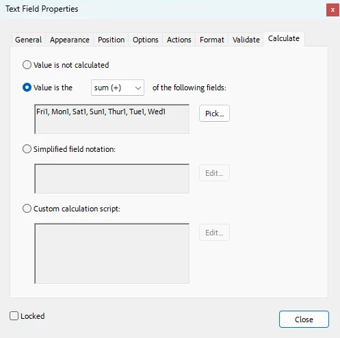

Hi @Nesa Nurani,
I think I'm making this more complicated than it needs to be. I currently have two calculation in place. The first calculates the sum of 'Week 1 Hours'; the second calculates the sum of 'Week 2 Hours'. I then added a third that calculates the average of 'Total Hours Worked'.
Is it possible to show the value of the 'Avg Total Hours' field only if hours are entered in both Week 1 and Week 2? In other words, if no hours are entered in the 'Week2' row, can the value of the 'Avg Total Hours' field be hidden?
In that case for "Total1" and "Total2" fields you can use built in calculation, go to those fields properties and under 'Calculate' tab select 'Value is the' and pick fields you want to sum. Then as custom calculation script of total average field use this:
var total = 0;
var avg = 0;
for(var i=1; i<=2; i++){
 var f = Number(this.getField("Total"+i).valueAsString);
 if(!isNaN(f) && f !== 0){
  avg++;
  total += Number(f);}}
if(avg !== 0)
 event.value = total/avg;
else
 event.value = 0;
