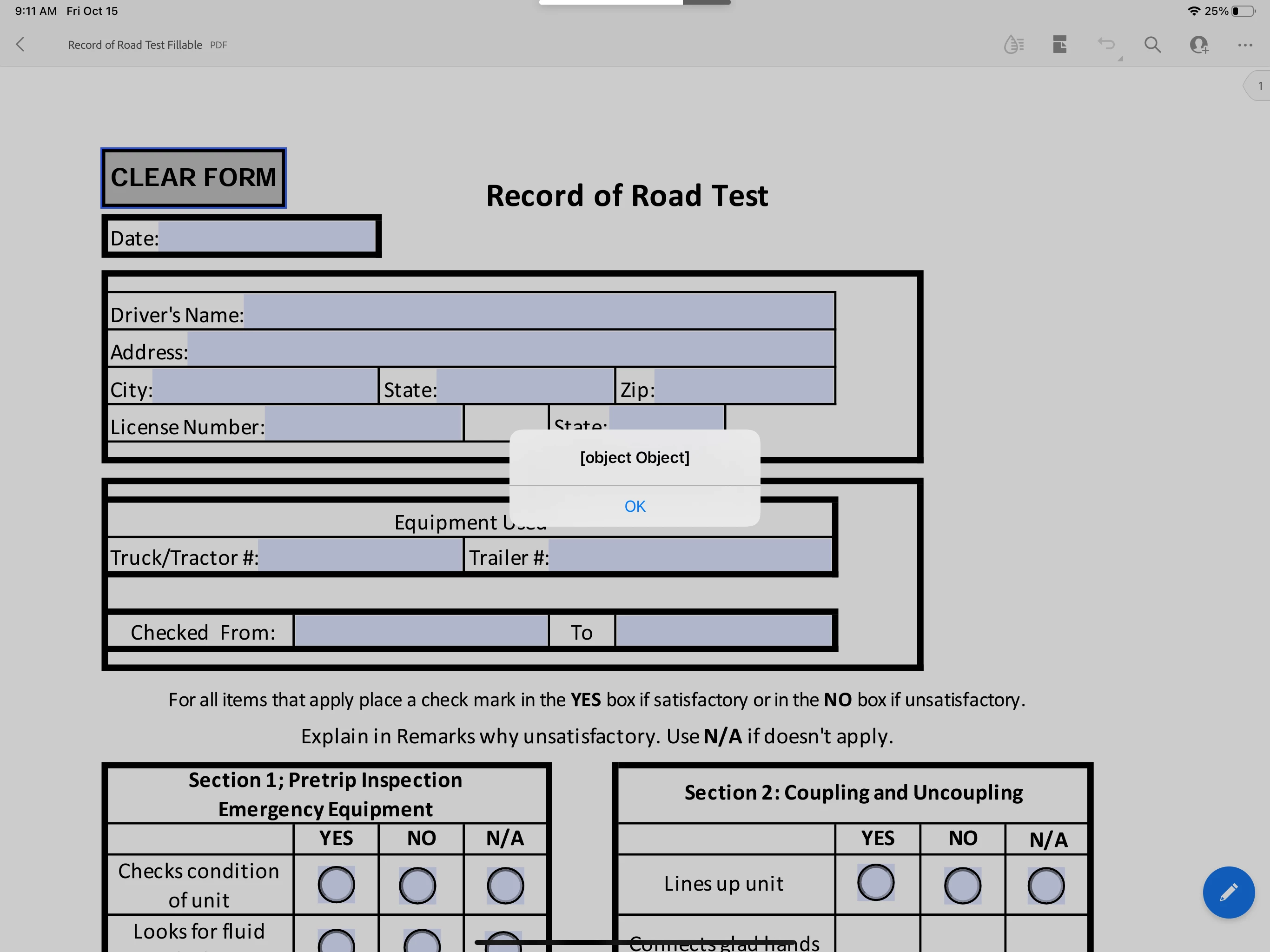

I have a button that clears all information on the form and gives the user a warning before they can clear the form.  The button works on the Macbook Pro however it does not work on the iPad.  The picture below is the message that I'm getting on the iPad when I press the "Clear Form" button.  The version of Acbrobat Reader on the iPad is 21.09.01.
Below is the code that I'm using on the Mouse Down action.  I don't necessarily need to offer the user to save the file, however I would like to give the user a warning message before they commit to clearing the form.

Correct answer try67
The mobile version of Reader has almost no support for scripts, unfortunately. You should try PDF Expert by Readdle. It has a better chance of working there.

try67Correct answer
October 15, 2021
BrentJMAuthor
October 17, 2021
I downloaded PDF Expert and it worked.  Thanks for the help.
