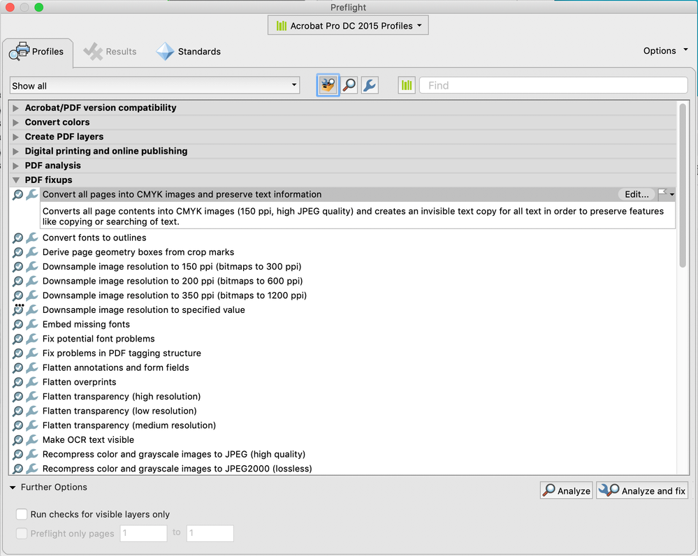

You could use an Acrobat preflight to convert all of the pages to cmyk images, making the watermarks almost impossible to remove, although this would likely increase the size of the PDF. Tools> Print Production> Preflight. You can edit a copy of the preflight and change the resolution of the image conversion (the default is 150 ppi).
Alternately, you could add the watermarks to a copy of the images in Photoshop and save as a new name, then export to a new (proof) PDF, which would protect your images, preserve the existing vector elements and produce a smaller PDF.

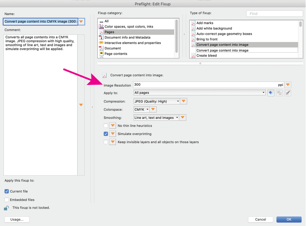

Thanks Luke. This solution may be able to work for me. The watermark doesn't merge with all the design elements, but enough of them to make the file unprintable without them. Is there any way to change the output resolution to 300 instead of 150 ppi? It looks a little fuzzy once this is done.
Aug 26, 2020 Aug 26, 2020
Yes, you can adjust the resolution, you first need to duplicate and re-name the existing profile (from the little fly-out menu), you can open and edit the new profile to change the settings.

This is great and solves my issue. Thank you Luke!

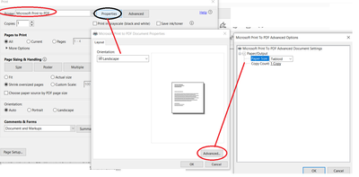

Print the file as pdf:
Select the printer as Microsoft print to PDF;
Through  Properties: select landscape,
Through Advanced option: Paper size to Tabloid
LEGEND ,
Jan 28, 2022 Jan 28, 2022
Printing a file to PDF is never recommended and DOES NOT flatten in the way that the original post needs.
