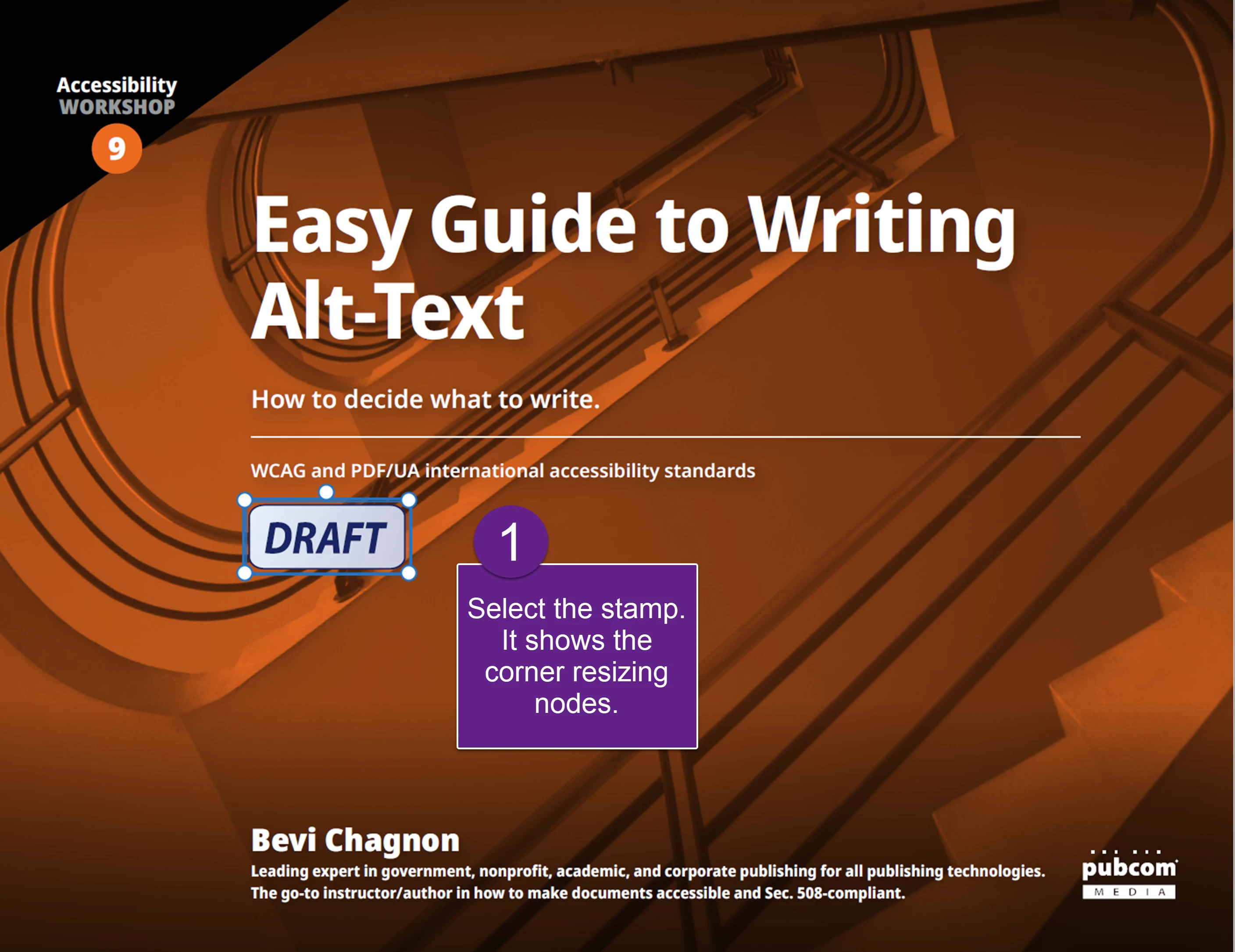

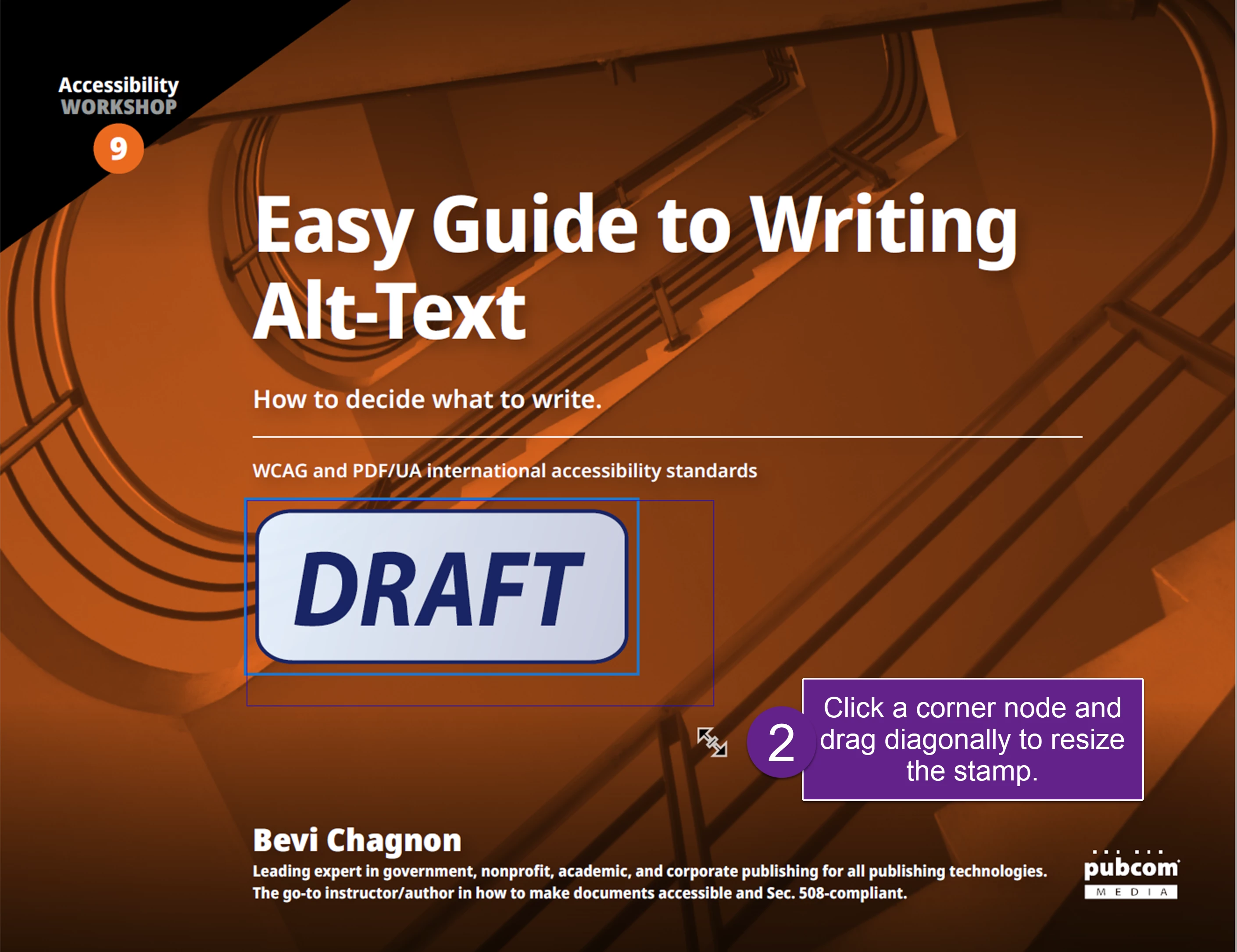

Easy way:
No matter what size your original graphic was made, and what size it became once placed as a stamp in Acrobat, you can easily resize the stamp in Acrobat.
  1. Place the stamp and select it. The risizing nodes appear on the corners.
  2. Grab a corner node and drag it to the size you want.

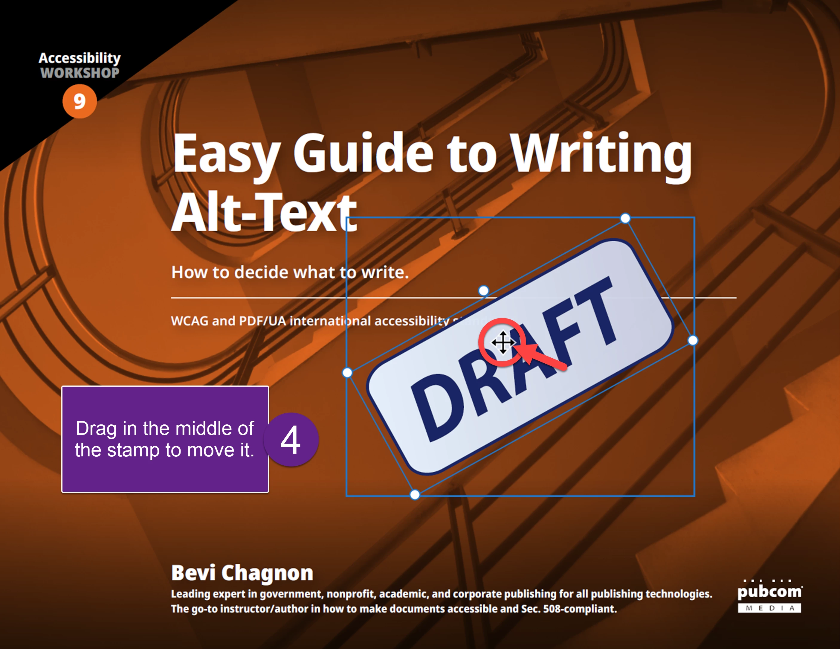

  3. You also rotate the stamp by grabbing the top center node and rotating your cursor clockwise/counterclockwise.
    4. And you can move the stamp anywhere on the page. Click the stamp in the middle and drag it.
