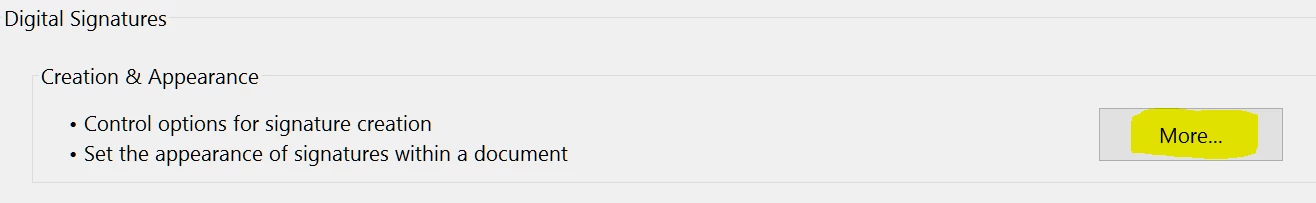

Please follow the steps to enable the Reason option while signing a PDF using Certificates:
  • Navigate to Edit>Preferences>Signatures.
  • Click on More under Digital Signature.
  • Under Signing, Select the checkbox Show Reasons.
  • Click Ok.
  • Click Ok again.
  • Close the PDF file and Acrobat.
  • Launch the Acrobat and sign the PDF.
  • The reason tab will be available now.
