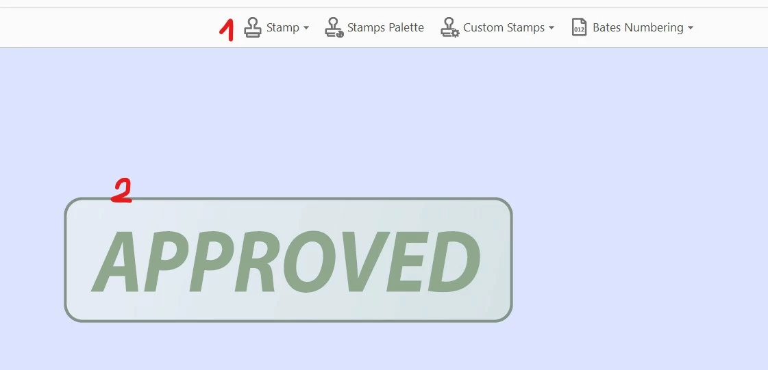

so maybe you know how to find "option or something where you can stamp more than once without having to click the stamp button each time?"
releated topic here, but I do not have this options in my Adobe Acrobat Pro DC (32bit) version
https://acrobatusers.com/forum/general-acrobat-topics/using-stamp-multiple-times/
try67
June 29, 2021
fantastic, work fine! - last question, its possible to set "pin" just only for one/specific stamp? <can be via JS>
how do you think?
Once you select a specific stamp and click the pin icon, that stamp should remain selected.
And no, it can't be done with JS.
