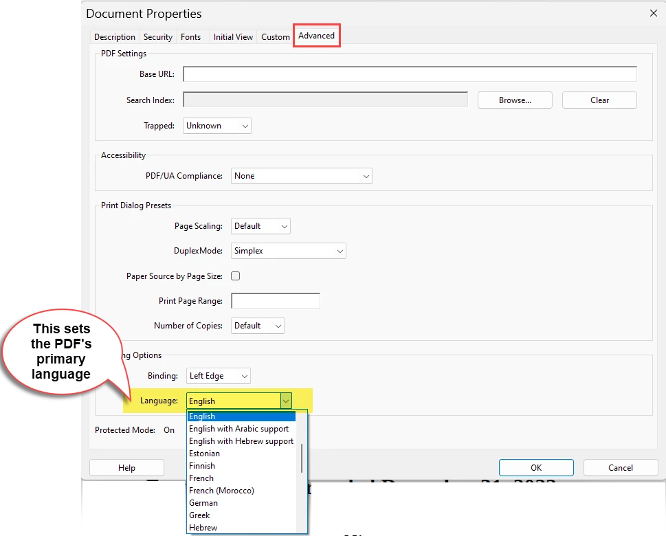

First, there are two ways to designate language in a PDF. One is global that sets the primary language for the entire PDF file, the other is for selected paragraphs or words that use a secondary language.
Try this:
1. Set the primary language in File / Document Properties / in the Advanced tab. For this example, let's select English as the global language.
Note that Hebrew and English as pre-specified in the drop-down menu.

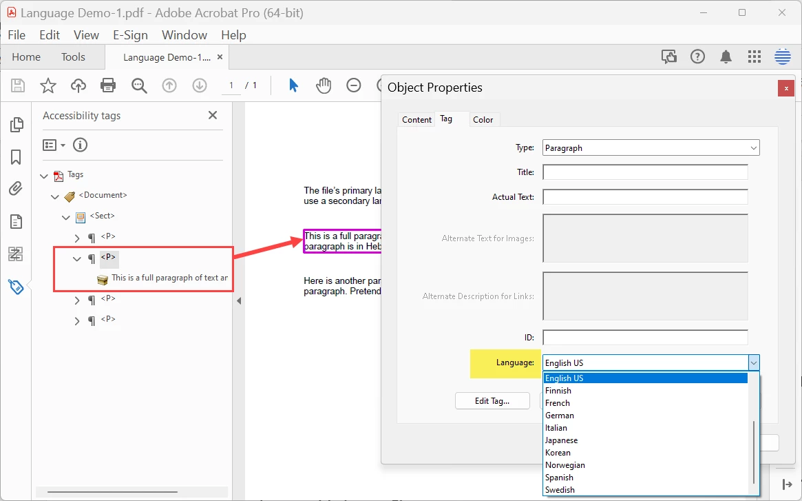

2. Set the secondary language for an entire paragraph of text, such as <P>, <H2>, etc.
Almost as easy to do!

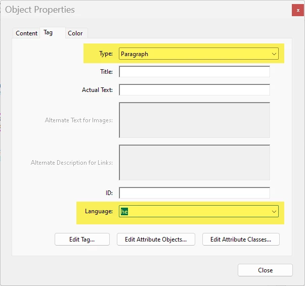

Select the tag <P>, right-click, and select Properties.
From the drop-down menu for Language, choose the appropriate language. Note that Hebrew is not pre-specified.
For any language that is not listed in the Drop-Down menu, you'll need to reference the standard ISO language codes called ISO 639. You can't type in the language's name.  See https://www.loc.gov/standards/iso639-2/php/code_list.php for a list of the ISO 639 language codes. When possible, use the ISO 2-letter code, not the 3-letter code. And these are case sensitive so carefully follow the chart.

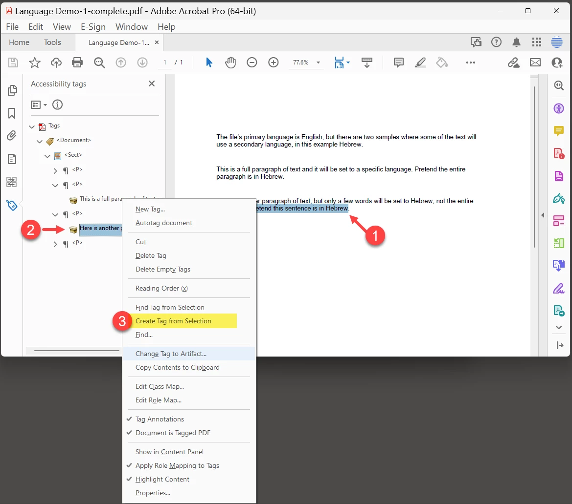

Step 1: With the selection cursor, highlight the text that you want to be in the secondary language.
Step 2: Right-click the yellow content container (not the tag) and Step 3 choose Create Tag From Selection. This function is a bit buggy in Acrobat, and you might not get a separate <Span> tag as intended,
Right-click on the <Span> tag and select the language as detailed above.

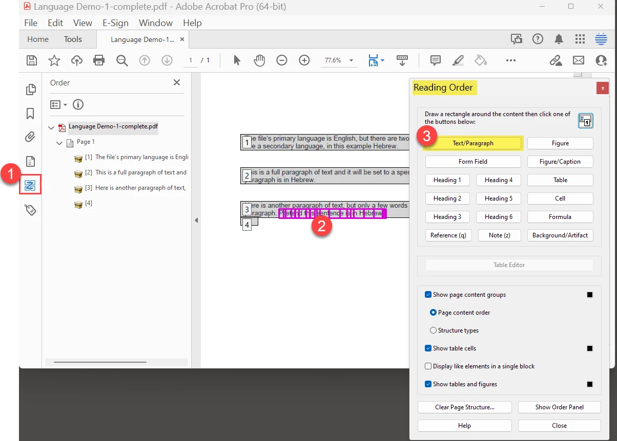

4. Since the bug in method #3 above might not have been corrected by Adobe, use the following method to manually add a <Span> tag.
Step 1: From the Order Panel, open the Reading Order tools panel.
Step 2: With the crosshairs cursor, select all of the letters (and punctuation) to be in the secondary language. You might need to drag-marquee one or more times to get all of the characters.
Step 3: Once selected, designate them to be Text Paragraph. We'll change this later to <Span> and drag it into the right spot in the tag tree.

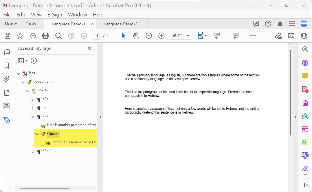

Step 4: Switch back to the Tag Tree and the new <P> tag will appear as a separate paragraph there.
Step 5: Right-Click, select Properties, and change it to a <Span> tag from the top menu.
Step 6: Then, drag/drop the new <Span> tag into the correct location in the tag tree, which is nested inside it's <P> and in the right reading order with the remaining text in the paragraph.
Step 7: And, of course, change the language on the <Span> tag as described above.
