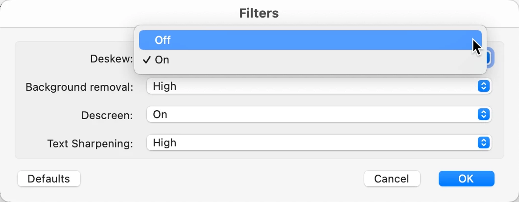

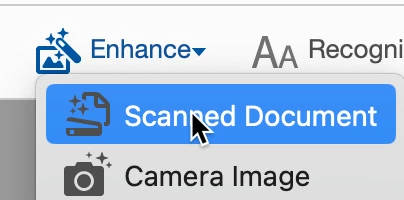

OK, I also had the Old UI going, so I used that.
First, go into Scan & OCR
Next, along the top bar, select "Enhance" and then Scanned Document
Next, click on the Gear icon for Settings
And lastly, on the bottom of the window (seen above) click on the Edit of  Text Recognition Options
Then go to Deskew and turn that off.
As a side, but related issue. I get a business-related journal that I scan for storage. On my flatbed scanner, I scan one side, flip 180°, scan the next page, wash, rince, repeat for all ≈ 60+ pages. With Deskew turned on, Acrobat's OCR recognizes that the text is 180° off and rotates the page back to 0° and I'm good to go. So, it definately has some advantages. So, when you're done with this, you might want to turn it back on.
Let me know if this solves your issue.
gary_sc

My guess is that it's focusing on these lines (in red) and not on the vertical line.
 Let me know if you're using the new or old User Interface and I'll tell you how to turn the auto-roate off.

gary_scCorrect answer
July 8, 2024
