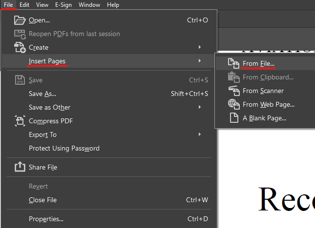

How are you currently doing it? Because as far as I recall if you use the Insert Pages command (NOT Insert File!) it should not carry over the bookmarks with it.

Thank you for the response. Bookmarks carry over if I use the method illustrated below:

Try dragging the pages from the Pages panel of the one file to that of the other and dropping them in the desired location.

Are you speaking about the "Page Thumbnails" page? That's usually how I merge files. My usual approach involves dragging files from the file explorer into the Page Thumbnails section, where I can drop them in the desired location but this preserves bookmarks.
If I open both files and drag pages from one to the other, the bookmarks don't transfer over. However, This method necessitates opening the document and consumes just as much time as removing the bookmarks, as I initially mentioned in the original post.

The only other option I can think of is by using a script, which I know won't copy the bookmarks over.
