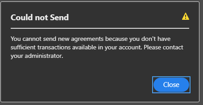

Notice, one transaction remaining.
When I add signers, then click "Specify where to sign",  it hangs on 72% for indefinite period of time.
So I do "More options"
I can unselect "Preview & Add Signature Fileds", then "Send" activates (instead of Next). But I would rather like to specify where to place the signatures. So when I leave this check box "Preview & Add Signature Fileds" selected and I hit Next, I get this:
See the very first screen shot, where it says I have 1 trasnsaction left.
FYI, my background is: I had in use two transactions last month (hitting the limit), but then I cancelled one of them before it was signed. It is surely you software problem and I am surprissed seeing this thread reported in April this year.
