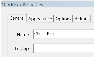

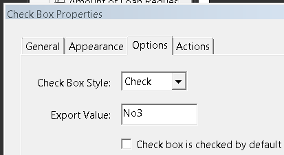

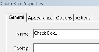

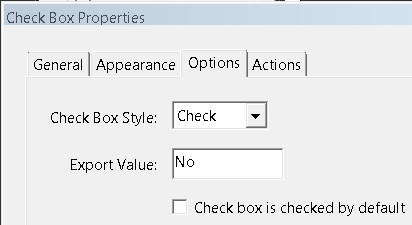

Ok.  All of my Yes's have the same group(field) name and completely different export values.  All of my No's have a different group name than the Yes group, but are the same for all of the No's and each of those have different export values.  Now when I test it, when I click a Yes, all of the Yes's are checked.  When I check a No, I can only check one out of that group.  When I click on another No, the first one disappears.  Also, I can still check No when there is a Yes check on that row.
Apr 28, 2017 Apr 28, 2017
No, that's not how you do it... Each set of Yes/No fields need to have the same name, but different export values.
So you have one field called "Check1" with an export value of "Yes" and one called "Yes1" with an export value of "No".
Then they will be the same "group" and you won't be able to tick both at the same time.

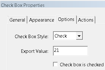

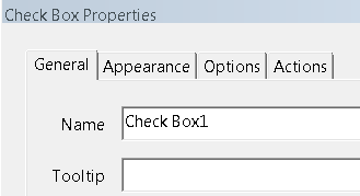

Ok, I have them all switched over to check boxes.  The "Yes" column has a group name of "Yes" and export values of "Yes, Yes1, Yes2", etc.  The "No" column has the name of "No" and export values of "21 through 28".  So all export values on each check box are different and the group/field names are the same.  However, when I test, only one "Yes" check box will stayed checked and only one "No" will stay checked.  They also let me check both on the same question.
Jun 08, 2017 Jun 08, 2017
Read my reply again. Each set needs to have the same field name, but different ​export values​.
