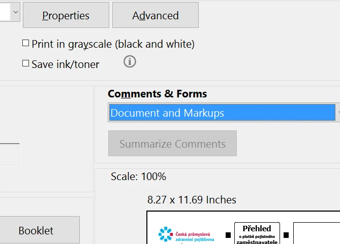

As mentioned above, that the forms send back to you by the users can be viewed in Acrobat but forms field are blank while printing. So, there are couple of possibilities, and any one of them might be causing this trouble-
  • Try printing the form "As Image" using Adobe Acrobat.
  • While printing the form, in print preview check what you have selected under "Comments & Forms" (As shown in pic)
  • As the form created by you, so you might need to check the form's properties whether its whether its properties allows to print or just view, but not print?
  • Please check with the end users whether they are filling the form in Mac Preview or Adobe Reader DC? ask them to use Adobe Reader DC for form filling.
Let us know the result.

Adobe Employee ,
Dec 11, 2018 Dec 11, 2018
Hi Dorothya,
We are sorry for the delay in response to your query.

New Here ,
Thank you so much for your reply!
I tried printing as an image and that worked!
I looked under File on the form and went to Properties and couldn't find
anything there that allowed or disallowed printing of the form. The form
always prints, it's just the fillable fields that don't print without
changing to Print as Image.
I can live with that fix.
Thank you again for your help! I have seen many people post about this
issue and have never seen the solutions you offered. I have tried all the
other solutions I have seen and none worked.

Go to the print menu
At the very bottom right above PAGE SETUP, under Comments & Forms, go to the drop down bar and choose Documents & Markups.  I have been wondering for years and finally discovered it not long ago.
Hope this helps!

Jan 28, 2024 Jan 28, 2024
This setting does not apply to fields, though, only to comments (of various types). The two things are nor the same, although people sometimes get them confused.
