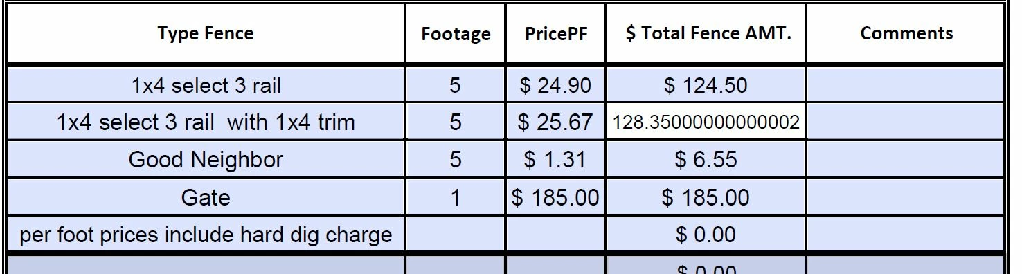

Can anyone tell me why my values are coming out as standard decimal notation?
There is nothing special going on here just Footage*price = total.  Some of my values come out correctly $ amount with 2 decimals and others are like this example 128.3500000000002.  Does anyone know how to correct the formating?  Also this is only happening with certain calculations.
5 x $25.67 = 128.35000000000002
6 x $25.67 = 154.02
Attached is also the file I am working on.

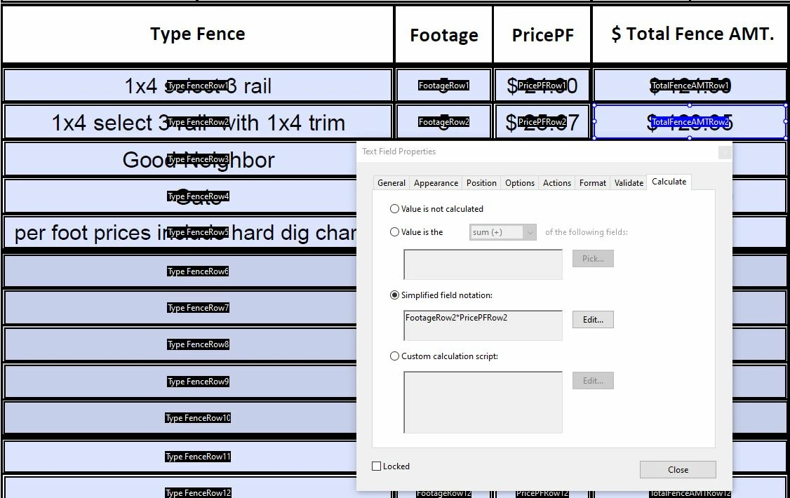

File attached has the script active but the Totals of Job does not seem to be calculating correctly.  Could you take a quick look and see if you notice what the issue is?
You need to fix field calculation order, your TOTALS OF JOBS should calculate last, and it's on the top of the list (should be on the bottom).
If you are still using old adobe interface, select 'Prepare form' tool then click on 'More' and 'Set field calculation order', make sure fields that calculate first are on top.
EDIT:
I would remove all of those calculations and use loop in one field to calculate all like this:

February 2, 2024
Thanks Nesa, I was able to add the toFixed() script and got it working.  I appeciate your help.
