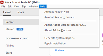

Community Beginner ,
Oct 22, 2021 Oct 22, 2021
Run regedit as administrator and it will allow you to edit it.
However as long as the value is 0 then the update option will be missing in Adobe
