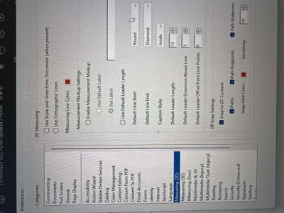

I was once stuck in the same situation but I realized You and I are missing one important step. (I will highlight it for you underneath) but for the rest of the viewers I will try to write down all the steps to get it done.
first you need to change the measurement units to inches
Go to
- Edit from top menu
- Scroll down to Preferences (Ctrl +K)
- From Categories Pan: Select "Units & Guides"
- Select "Inches" from "Page & Ruler Units" drop down menu
- Press Ok
Now Select "Measure" tool.
Go to:
- "View" from top menu
- Scroll down to "Tools"
- Scroll down to "Measure"
Select "Open"
- Select "Measuring Tool" from Menu bar
- Right Click on Screen
- Select : "Change Scale Ratio and Precision"
Change Ratio as per the drawings. In my case it is 1/4 = 1 Foot therefore I changed it to 0.25 = 1 Ft
Now here is the KEY STEP
Right Click again on screen
Go to Preferences
Select: Measuring (2D)
Uncheck Box which says: "Use Scale and Units From Document (when present)
Done
Community Beginner ,
Jul 18, 2024 Jul 18, 2024
Yes! UN CHECK  "use Scale and Units From Document (when present)"
took me awhile to figure this out also. (i over looked this on your answer a few times) i had to look on my other computers settings.
THX!
