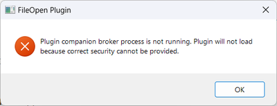

Hello! I've been getting the error message below for the past week or so with ALL pdf docs I try to open, whatever the file, whereever the location. Once I click OK, the message disappears and the document opens, but it will come back each time pdf Reader loads.
So for, I have tried the following, without effect on the issue:
  • unchecked the "use only certified moduyle on launch" option - as stated on Adobe forum
  • unchecked the protected mode on startup in the sandbox protection menu - as stated on FileOpen forum
Thank you for your help

Hi @sophiel90593090,
Hope you are doing well. Sorry for your experience with Acrobat Reader.
This error is caused due to the file FileOpen Client Broken getting corrupted. This can be caused due to a lot of reasons.
However, let's try reinstalling the application using the cleaner tool.
Please run the Acrobat cleaner tool https://www.adobe.com/devnet-docs/acrobatetk/tools/Labs/cleaner.html, reboot the computer once, and install the application using the direct link Adobe - Adobe Acrobat Reader DC Download | Free PDF viewer for Windows, Mac OS, Android

Hi,  After some deep consideration, I decided to simply re-run the latest version of  "FileOpenInstaller.exe".  The good news is that it fixed the problem.  It was straightforward as I have a habit of keeping a copy of the latest version of the executable each time FileOpen requires that it is renewed.  I hope this feedback helps everyone!

New Here ,
Mar 30, 2023 Mar 30, 2023
Thank you! I tried the cleaner tool and reinstall and so far, so good!

Community Beginner ,
Feb 12, 2024 Feb 12, 2024
I get the same error.  If I reinstal the file open plug in, it will work fine until the next time I reboot the computer.  At which time, the error comes back until I reinstal it again.
Mar 11, 2024 Mar 11, 2024
File open support responded to requests for help and we finally found this to work for me.
If you just installed the FileOpen client plug-in and this is your first time trying to open a protected file, then you need to get the FileOpenBroker64.exe running. You will also want the FileOpenBroker64.exe to start every time you log in to the machine. To do this you can create a shortcut to
C:\ProgramFiles\FileOpen\Services\FileOpenBroker64.exe
via
C:\Users\YOUR USERNAME\AppData\Roaming\Microsoft\Windows\Start Menu\Programs\Startup
