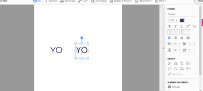

Hi, after every pdf export I need to do a post-processing work that utilizes the fonts in a pdf. Unfortunately Adobe Express converts some fonts to vector and doesn't embed the fonts. Here is an example, these two texts: the first YO is using Montserrat Regular and the second YO is using Poppins Regular. After exporting to PDF, the Montserrat font is not embedded into the pdf(the text is transformed into vector) and only the font Poppins is embedded in the pdf. (I attached the express PDF export file below)
Adobe Express:
 Adobe Acrobat (the first YO behaves like an image, the second YO I can click and edit the text)
 Checking fonts that are embedded (only Poppins).

I did the first step but the same thing is happening. Here is the pdf (you can check that only Poppins font is embedded).
I don't see how the second step would solve the problem as the export file should be pdf.
Yes, this issue is present in various fonts. Some get embedded and some get transformed into vector.
