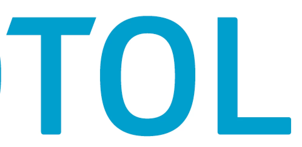

HI All,
I thought I would post here for answers first before reaching out to adobe. I have searched for answers on the internet, with no real result. I am having issues with the color changing when I import a .AI file to After Effects. The Document color mode is RGB. I created RGB swatches for each color and applied to the shape of the logo. I have Assigned Profile Working RGB: sRGB IE61966-2. Attached is an image from Illustrator (1) and an image from After Effects (2). Any suggestions would be appreciated.
Views
90.9K
Community Expert , Mar 28, 2019 Mar 28, 2019
Try going to the menu File / Project Settings ... / Color and choose the same color profile.

Boring standard answer: Arbitrarily assigning color spaces and profiles does nothing unless you actually work with full color management. That's basically your answer there. You are messing this up somewhere by not using the same settings and not using e.g. the correct proof preview in AI. Even the automatic gamut correction in AI's color mixer could be at fault here, if you create your alleged RGB colors using CMYK or HSB sliders. I would suggest you leave this be and just use a non-profile dependent workflow by resetting all settings to their defaults and relying on the monitor only.
Votes
Community Beginner ,
Copy link to clipboard
Copied
It worked! Changing the color profile in After Effects was the answer.

its very hard to find out the solution for this but i got that first go to the project setting and change same color as ai for example sRGB iec than after you done go to your diplay perview panel and select use display color management and Boom you see the magic is happenScreenshot 2020-12-24 at 12.36.04 PM.png

Both of my Ai and Ae color settings are synced. Still not getting the proper color like illustrator. Finally, your solution helped. But for me, my display preview was set to color management. When I selected RGB, it got fixed.
Votes
Oct 28, 2022 Oct 28, 2022
Copied
Sorry. This doesn't fix getting the proper color after export. Somehow I selected "none" from the color management and then selected "sRGB". This finally fixed the color using the display color management in display preview.

been racking my brain for years and this option of unclicking "CMYK Postscript" did the trick, Good luck to all with the same issue.

I worked! But not from the start. At first it didn't work. I've spent few hours trying to find a solution. At the end, reading someones comment about using spot color swatches in Illustrator, I've realised that i didn't check that. Turned out the original illustration was using color swatches defined in CMYK (facepalm). After changing these swatches to RGB all works perfectly!
