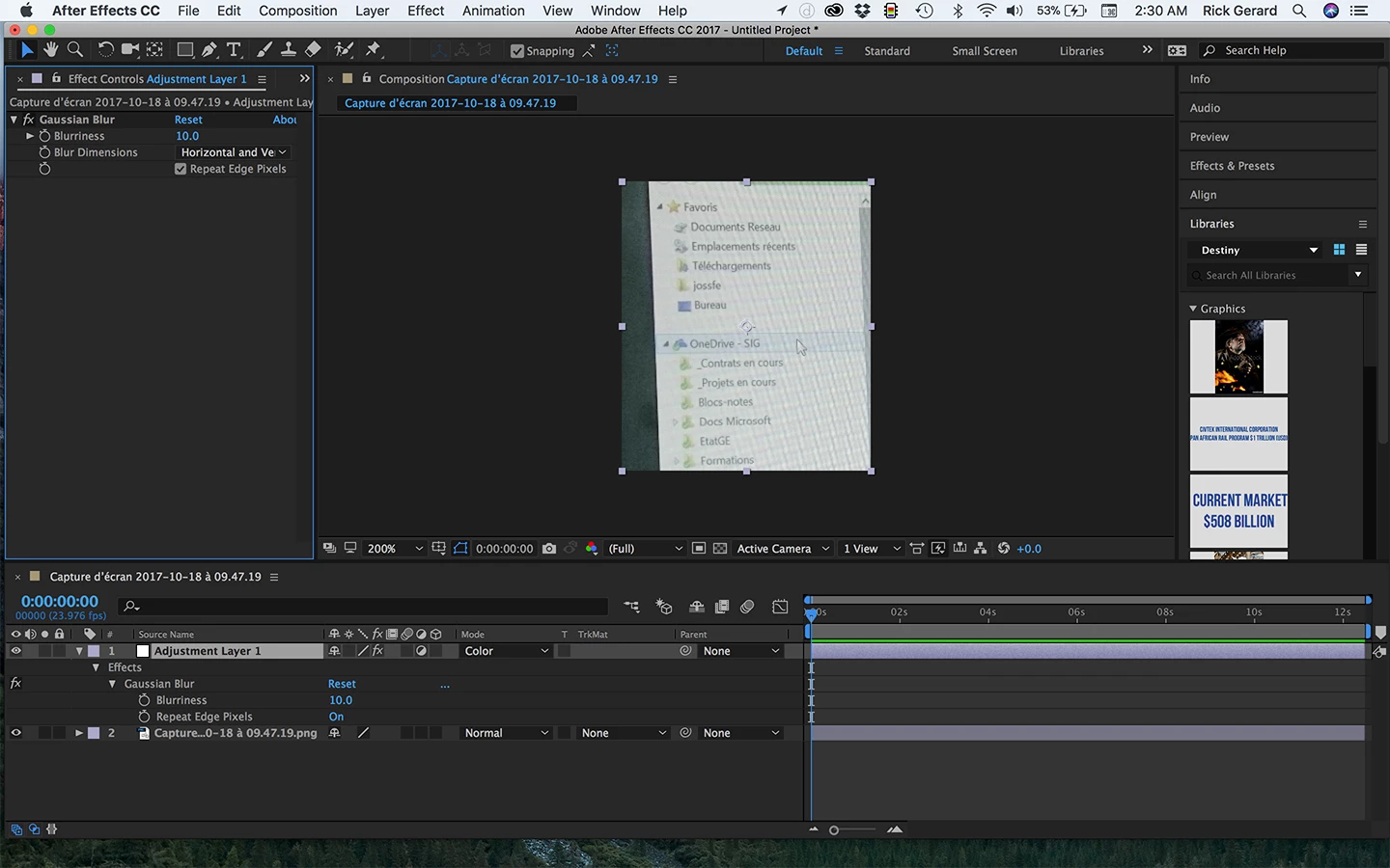

    The color banding is gone but the lines remain. Maybe that's good enough:
