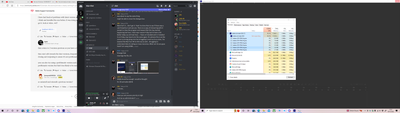

animate is bearly working
Explorer ,
Dec 02, 2022 Dec 02, 2022
been on this for 10 mins... 0%.cant work like this.........
7.1K
Explorer ,

Explorer ,
Dec 05, 2022 Dec 05, 2022
Hi, What will this achieve saving in increments as opposed to just saving as A,B, C, D, E.....
its slow for this file... also keep getting a dialogue which cannot be closed

Explorer ,
I have had loads of problems with latest version and now the previous version. I was using 23 i think and installed the one before. It was doing ok then now i have this dialogue issue... dont get it. look at video.. wtf!
