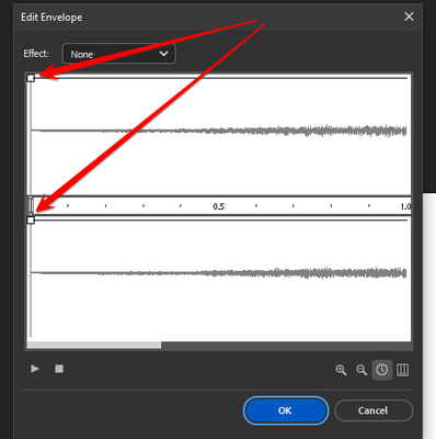

Jun 01, 2024 Jun 01, 2024
you should see something like this
see the lines above the sound profile and that box at the top of the left and right channels?
the lines represent the volume effect done by animate.  the pic shows an unchanged sound with no changes made.  the boxes are control handles.  you can drag them down to decrease the sound's volume.
click the line to add more control handles.  rather than me give an exhaustive tutorial, experiment and ask more questions if you need more help.

so i kind of figured it out. it  seems you have to make the square dots make a curve going down. oddly sometimes moving one on the bottom will make one on the top move and vice versa. why does this happen? you can play what you have however there is no line or anything that moves while it plays. there seems to be a little bit of guess work.
