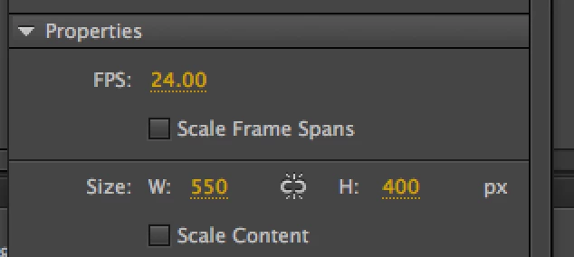

Animate recently added the ability to change the frame rate and have the keyframes spread themselves out. However much time it takes for the Stream audio to play is the correct value, and all of your animation with Event sound so far is based on the performance of your machine.
Suppose that your animation that should be done by 4 seconds is not done until 5 seconds, you could change the frame rate from say 24 to 30 fps, without using the frame span feature, then change it back to 24 fps with using the span feature. It should make the animation get back in time with the Stream audio.
