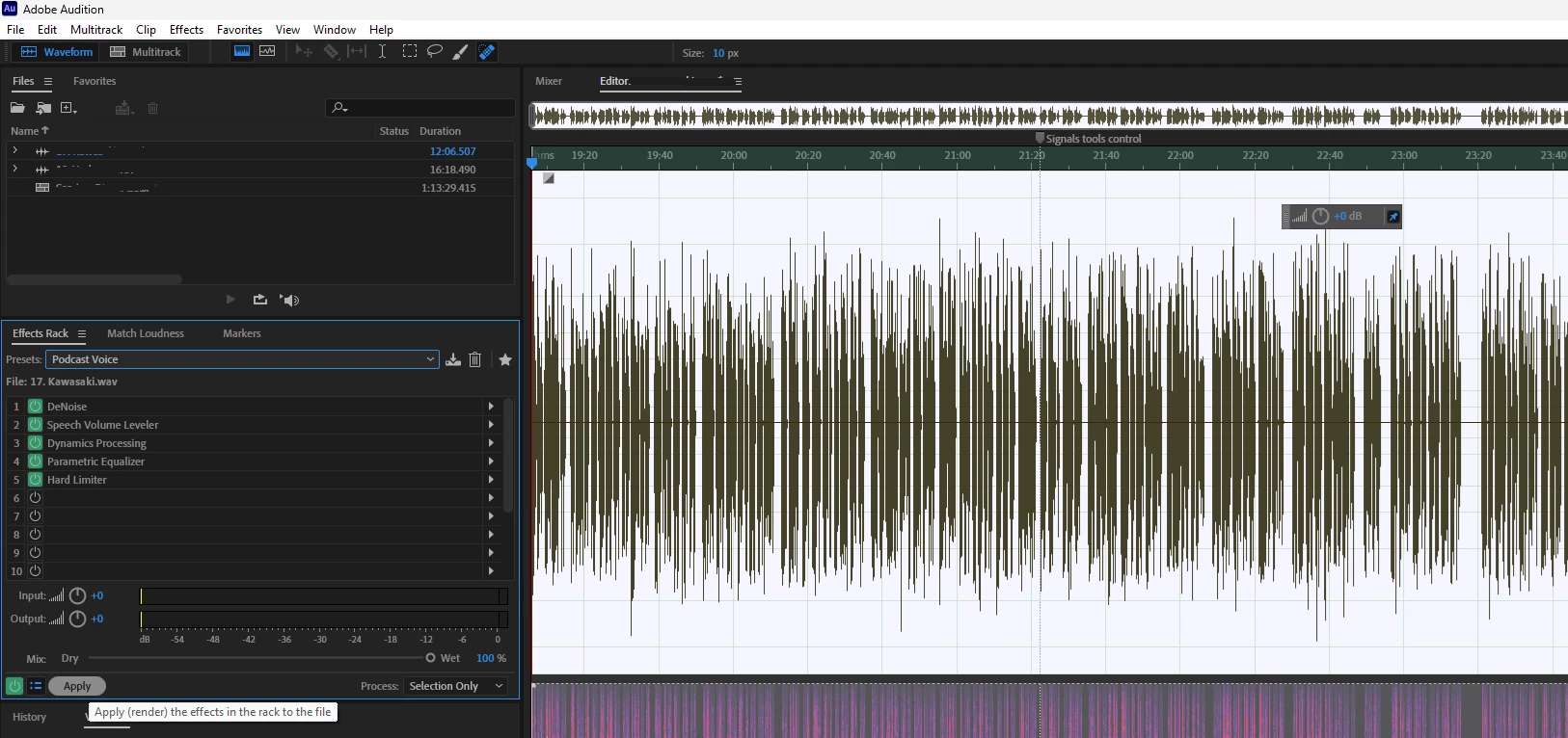

Sorry maybe this is a stupid question since this should be obvious but I'm not 100% sure. If I open a track in Wavefrom view, and select all or part of the track, and then select an Effects Preset do all the Effects e.g. 1, 2, 3, 4 & 5 inside that Preset get applied to the track one by one in that order once I click Apply?Adobe_Audition_question.png

That is the general idea, yes, and the order can be significant.
I should point out that presets are only supposed to be a starting point, because no two voices are the same, so 'fixed' processing as such, may not always be correct or relevant. The most extreme example of this is the Podcast session template; use of this is extremely likely to completely screw your results (as many have found), and should be avoided at any cost. In the example you've shown, things don't appear to be too violent, but you should always be critical of the result - the preview button is your friend!
