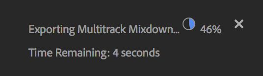

Hi The Artworker - Happy to hear that mixdowns are now working correctly for you.  If your Editor window is open, you should see exporting progress dialog.  It does not show if you are on the Mixer Window.  Please let me know if that is not the case for you.
