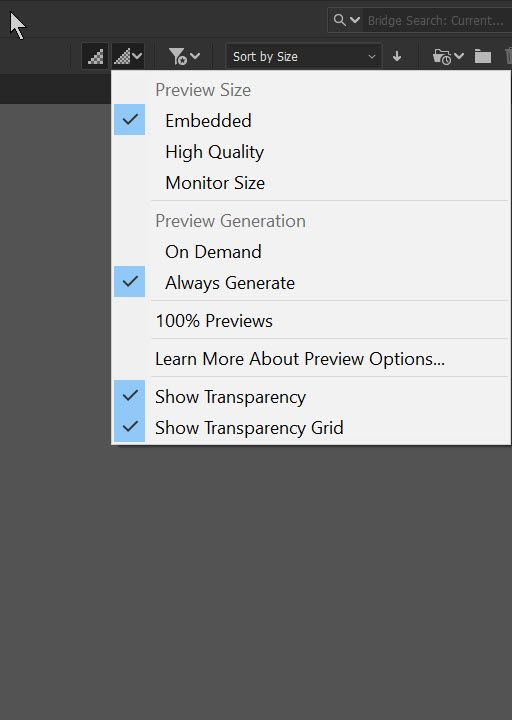

Mar 26, 2021 Mar 26, 2021
Copy link to clipboard
Copied
have you tried this preferences2021-03-11_18-31-22 Bridge  preview setting.jpg configuration?
Votes
Community Beginner ,
Copied
Thanks for the quick reply! Yes – I had actually changed the setting from "High Quality" now to "Embedded". I will keep an eye on this for a while. Thanks for your feedback. 🙂
