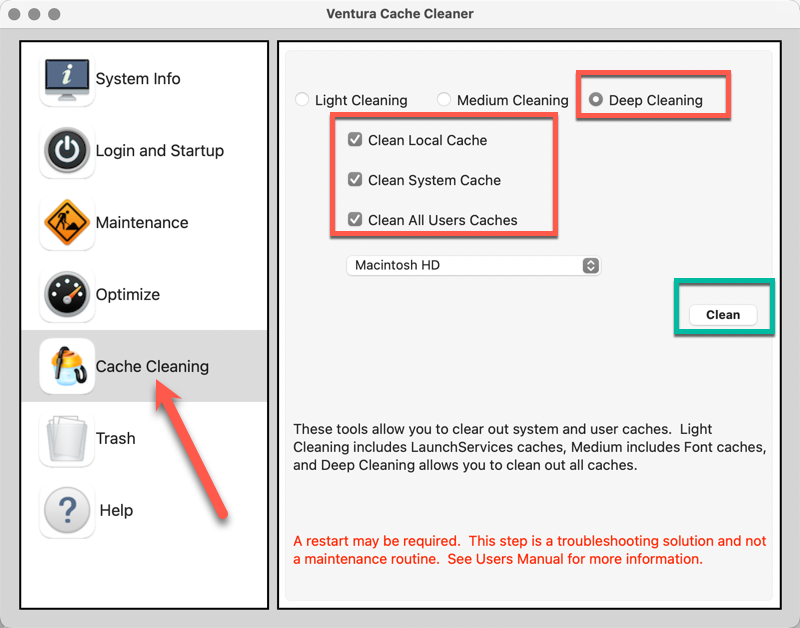

So, I went to an application I've used for years for just these situations: ~ Cache Cleaner (the ~ stands for the Apple OS at the time, currently Ventura Cache Cleaner). It's not expensive, and you do get a 10-day trial for free with full resources. Ergo, it costs you nothing to try this other than an hour of time. [When I first had an issue (with Acrobat back in 2007), I tried it, and it saved me so much grief that I've always bought it then and subsequent updates, but that's what I did, your call.)
Here are some instructions if you choose to try this:
Please go to https://www.northernsoftworks.com/ and download Ventura Cache Cleaner. You can use this for ten days as a free test. (Until you pay for the software and get your user code, you will have to wait about 10 seconds before using the software at full capability.)
After starting the software, go to the Maintenance tab, click "All," then click "Run."
You may be asked to reboot your computer at this point; it varies.
Now select the Cache Cleaning tab. Select Deep Cleaning, check all three Caches to clean, and then click "Run." You'll probably be asked to verify which cleaning you want and say yes to all as they show up. You will be asked to Restart your computer, and you may be told something went wrong, and you need to restart and run this process again.
I CANNOT say that this will fix this issue. Actually, I doubt it, but it's worth a try (and I'm curious if it will work or not). At a minimum, it will only take a bit of your time.
