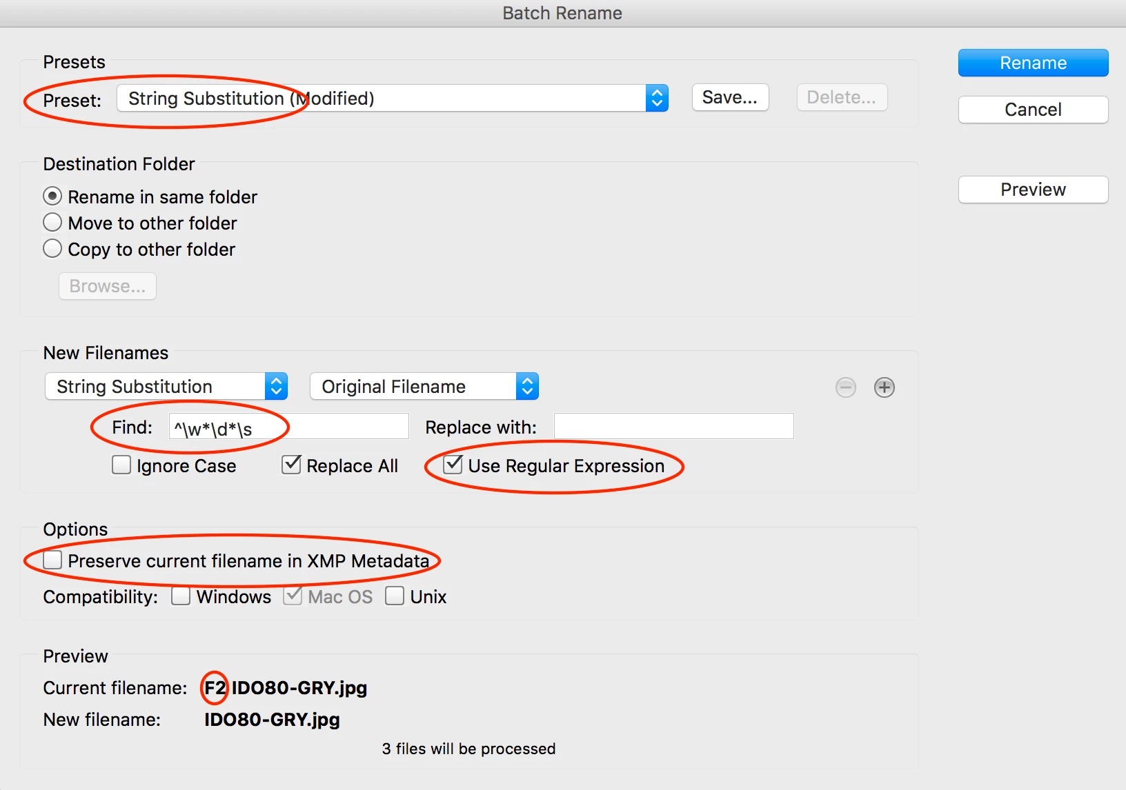

Hi everyone
I'm trying to use Batch File Rename in Adobe Bridge to strip out characters left behind by the photographic stage.
eg.
I want to search with a wildcard to eliminate the F1, F2 etc and space and leave the IDO60... etc intact
Is this possible? I tried using F* but it doesn't work.
Cheers
    Correct answer Stephen Marsh
    Hi martinl47003580, you need to use a regular expression based string substitution search/replace:
    Find: ^\w*\d*\s
    Replace: (blank)
    The above regex will look for zero or more letters and zero or more numbers and then a single space at the beginning of the filename.
    I have tried to make this expression a little more versatile/robust than your sample filenames which could have used a very simple/explicit expression:
    F\d\s or ^F\d\s
    However what if you ever had files that started with a different character than an uppercase F? Or what if you ever had two or more digits following the letter before the space? This is why I went with a more flexible/robust expression.
    It is usually a good idea to tick the “Preserve current filename in XMP Metadata” when batch renaming, so that you can easily recover the original filenames if required.
    EDIT: Looking at this a second time, an equivalent result and perhaps “technically better” would also be achieved with ^\w[0-9]+\s or how about ^\w+\d+\s or perhaps even ^\w+?\d+?\s etc. This is the great thing about regex, there are many ways to get to the same result (some verbose, some more elegant) – it all depends upon the context/use and how flexible the pattern recognition needs to be! Some other variations could be F.+?\s or ^.+?\s
    P.S. You can save this search/replace as a preset using the save button at the top of the interface.
    Find: ^\w*\d*\s
    Replace: (blank)
    F\d\s or ^F\d\s
    marketingc39907871
    February 14, 2017
    Thanks Stephen. Very helpful. I ran a few batches using your search string and it worked perfectly.
    Martin
