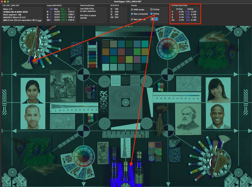

Aug 25, 2022 Aug 25, 2022
If you can upload one of the raws to something like Dropbox, I can examine the raw Histogram in RawDigger and at least get some idea of that actual data and exposure which plays a profound role on noise. I could report back what's actually in that raw, without any LR processing taking place.

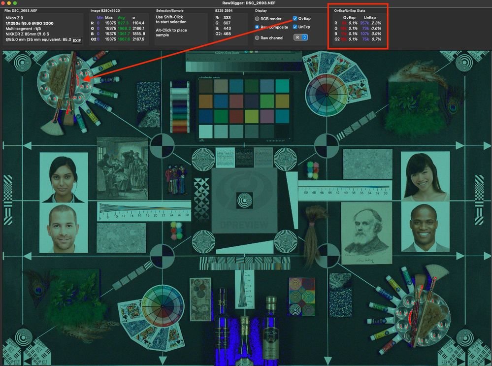

LEGEND ,
Aug 26, 2022 Aug 26, 2022
@Per Berntsen wrote:
Since you think that the Z9 performs  worse than the Z7, I download test files from both cameras from DPreview shot at ISO 3200 to see for myself.
There would be even less noise there if the DPR folks had been a just a tad more careful in their exposure. Anything with the blue overlay is underexposed so we should expect to see more noise there than necessary:
RawDigger allows us to now alter this preview as if we actually added more exposure at capture. If I add .5EV exposure, I'm just getting a tiny clipping of specular highlights in on the metal paint dish in the upper left. But less noise.
What this shows as well; the DR of the scene exceeds the DR of this capture.

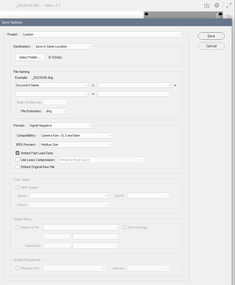

Mar 19, 2024 Mar 19, 2024
The grain is most likely caused by the way you have exposed and/or edited the images.
Please provide a sample image, saved as a DNG, this will include all the edits you have done.
(if you use Lightroom Classic, export as DNG)
Upload the DNG to Dropbox or some other file sharing service, and post the link here.
