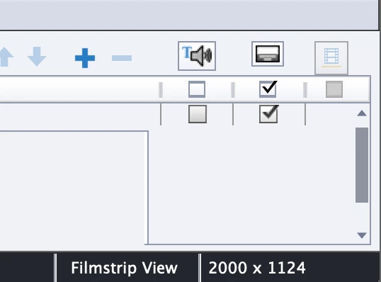

I am Running Captivate 2019 on Mac iOS Monterey. I am in the middle of about 20+ files that need to have the text and cpations exported to Word files for an English to Spanish translation and I have hit a road block. Up until this point I have had no issues, however I am now running into this problem where I open my Captivate file, click to export the captions and closed captions and it runs the export with no issue. But when I go to open and view the Word file after there is nothing there! I am attaching screen shots of the flow from what I see on my end from the export showing all the exporting preview text but then when I open the Word file it is just a blank page. Any help and advice would be appreciated!

Thank you both for the quick responses! I apologize for the late reply here, I have been traveling. As it turns out I was able to successfully export my files after turning off the closed captioning that was set to these particular problem files without me knowing. For anyone else who may find there way here with a similar issue the path to view the captions it is Window > Slide Notes , then at the bottom where the timeline is you'll see where you can toggle on/off the captions (below). I did not have to remove them to have a successful export, I just turned them off.

This may sound as being a stupid question, but it has happened a couple of times with other users. The export keeps the text formatting (object styles for captions and shapes). What was the color of the texts resulting in the Blank pages? I see in the screenshots that some colored text appears fine.
