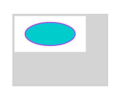

When I add HTML 5 media to a project, it comes with a large area around it that is not in the original file (see attached).
The grey area is added by Captivate.  The blue bit and the white around it is the original image (a button built in Flash, although Edge Animate does the same thing, other images and shapes do the same).
The grey box is 400x300 pixels.
How can I make it go away?  I only want the object, not all the spillover.  How can I trim it off?  It also appears to have a small grey border around the entire animation.  I have not found a setting for this.
Any thoughts?

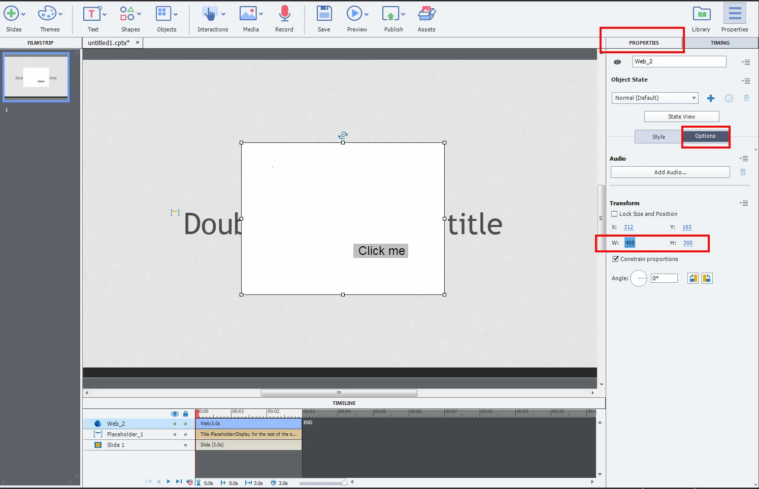

    400x300 is the default size for the imported media. If you select the media item and then click the Options tab in the Properties window, you'll find width and height fields that you can change. Just click inside them and set the width and height to the actual dimensions of your imported media. (Screencap below is from Cap 9 but its similar in Cap 8).
    To get rid of the border, select the Style tab next to Options and uncheck the box next to the Border option.
