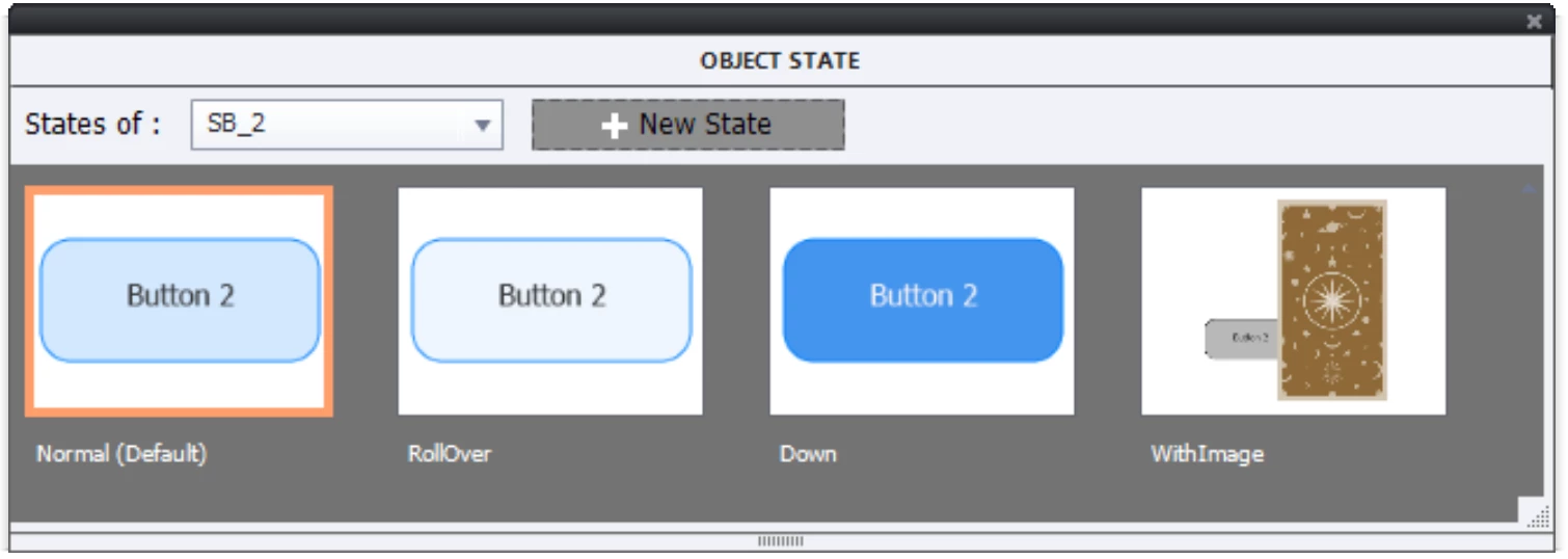

    I quickly create a small project. The three buttons are labeled SB_1, SB_2, SB_3. Here is a screenshot of the Object states of the second button:

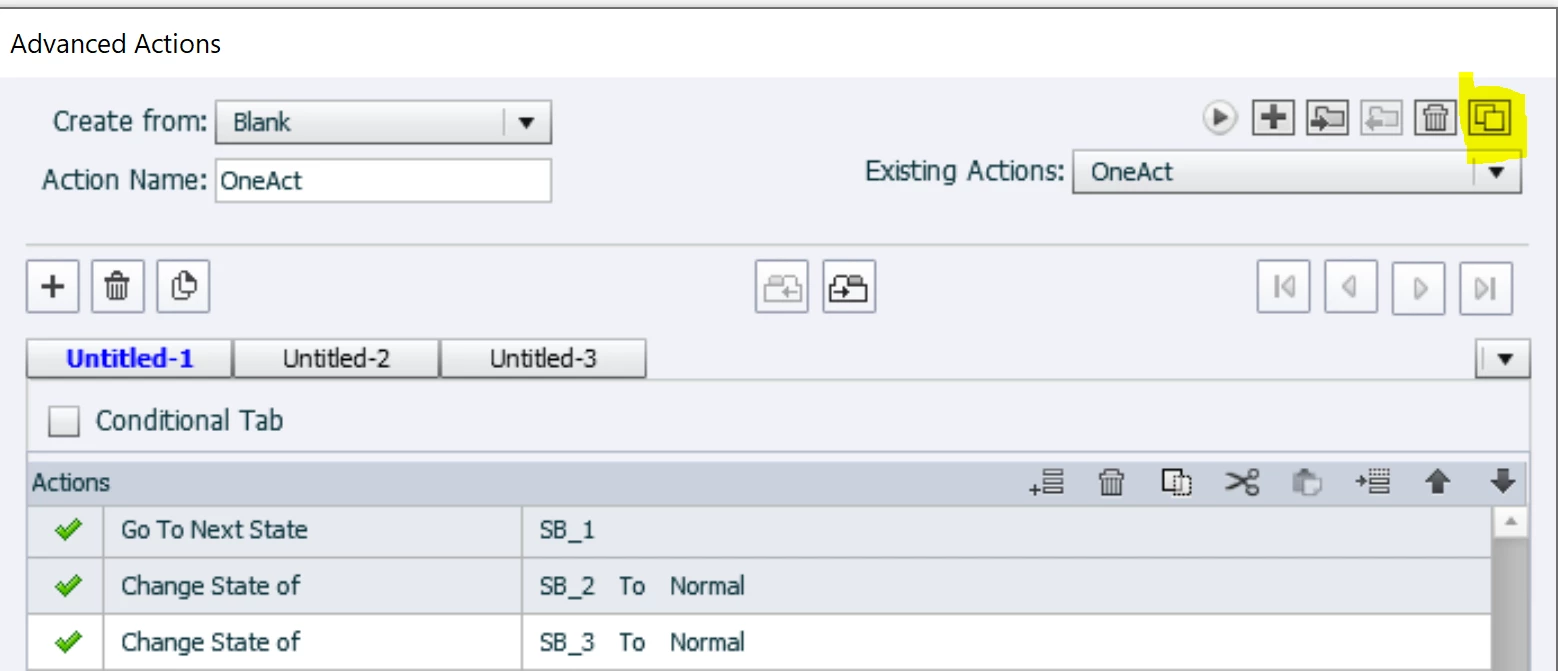

    For the first button, create this advanced action OneAct (never use the same name for an action as you used for an item):
    You see that I marked a button top right, use that button to create a duplicate for the second button, which you rename to TwoAct. You need to replace SB_1 by SB_2 in the first command line, and replace SB_2 by SB_1 in the second line. Create another duplicate for the third button, where you apply similar changes so that the first line has SB_3 and the last line SB_1.
