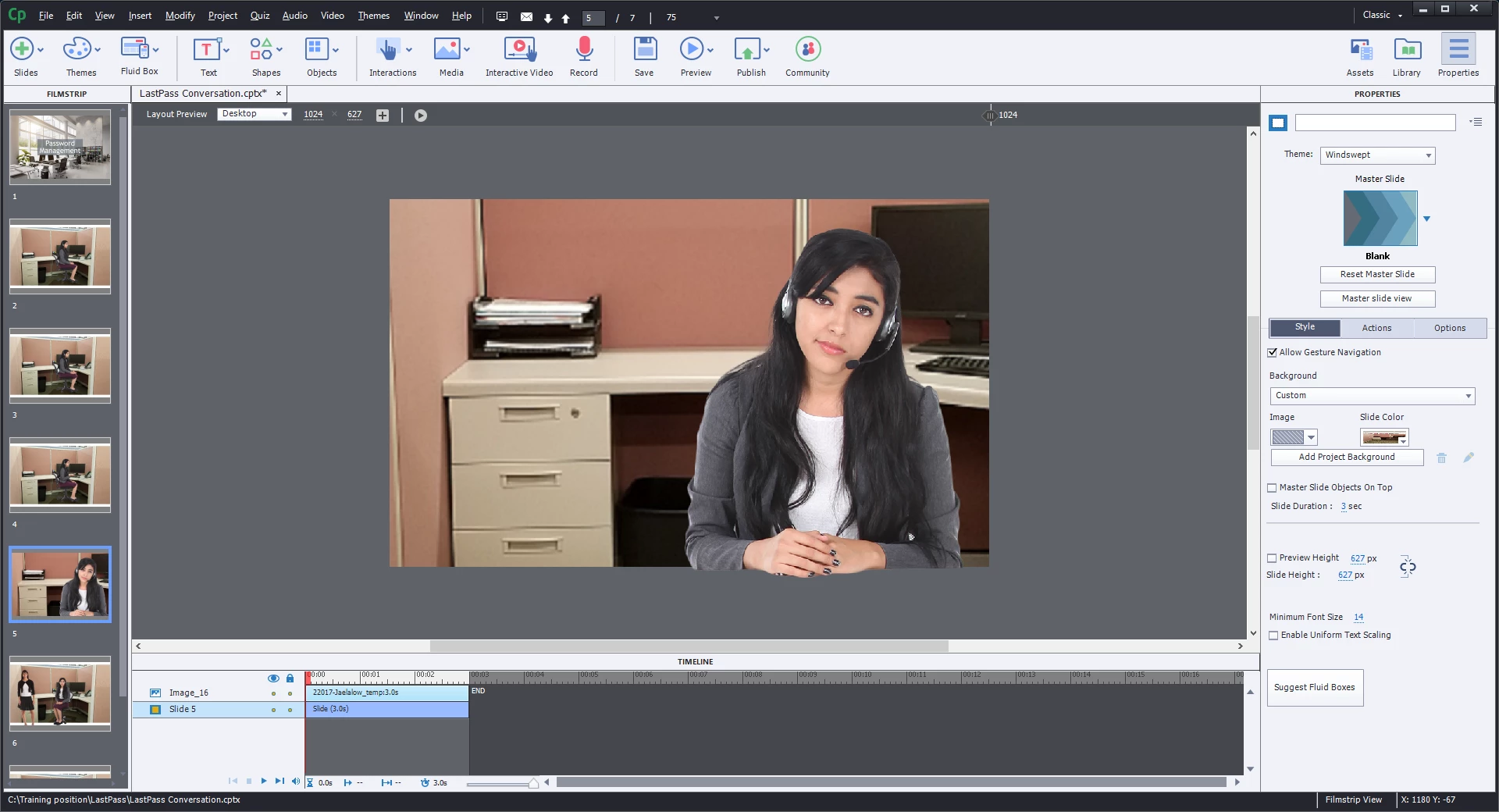

Hello All,
  I am using Captivate 2019 11.5.1.499. I created a responsive project and want to change the background image of one of the slides. The image size is large, but no matter how I try to edit the image, it is always imported at a size of 352x627 and is centered on the back of the slide. this leaves a lot of white space on either side. I have created different versions of the image, but when it is imported, it always reverts to 352x627. I am not using fluid boxes. Any ideas why this is happening?
Cheers,
Peter

    Hello All,
      I was experimenting with custom background images and got something close to what I wanted:
    I do not yet understand why I had to use custom background versus project background. This probably goes hand-in-hand with my lack of use for backgrounds.
    Peter

    You are not using Fluid Boxes, which means you do use Breakpoints since it is a responsive project.
    Can you show the position properties of the image?

      Thanks for the prompt reply. Here is the first image:
    Here are the image properties in Captivate, note the size of the image after import:
    Here are the image properties in Windows with the image size:
    I am unable to find position properties for a slide's background image. Can you provide instructions?

      Thank you for your reply. I deleted the background image and imported it again. I was unable to un-check fit to screen during the import. I am also unable to find the position properties you mention.
    On the import, the image size is correct; but then reduced during the import process. Is this a result of my using a responsive project versus a blank project?
    I appreciate your suggestions!
