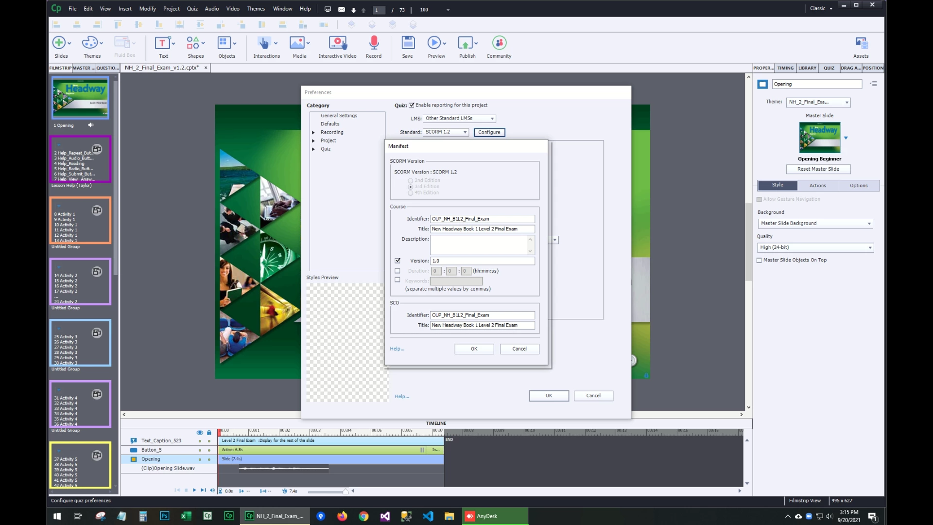

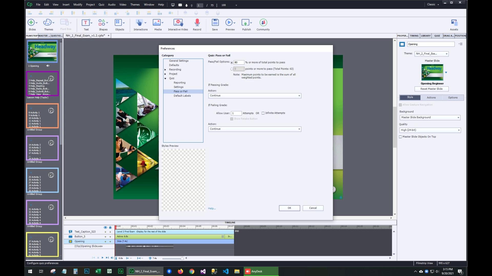

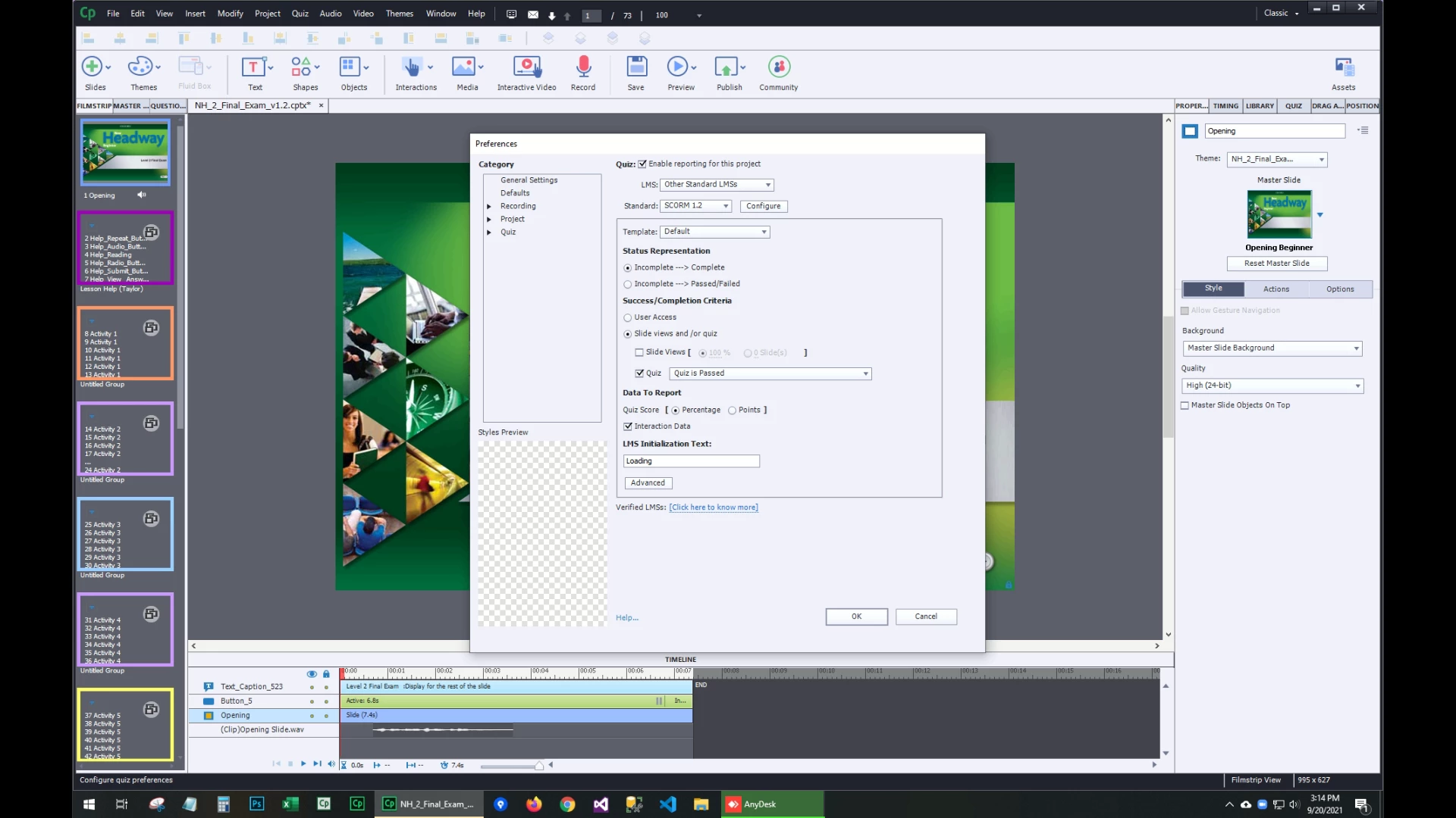

Captivate version is 2019 11.5.5.553 and a previous 2019 version I didn't record the number of before updating. Course is multiple-choice non-responsive project published as SCORM 1.2, quiz settings below.
I've tried setting the Status Representation to Incomplete -> Pass/Fail, and Incomplete -> Complete with Quiz Attempted as the Completion Criteria, but the issue persists.

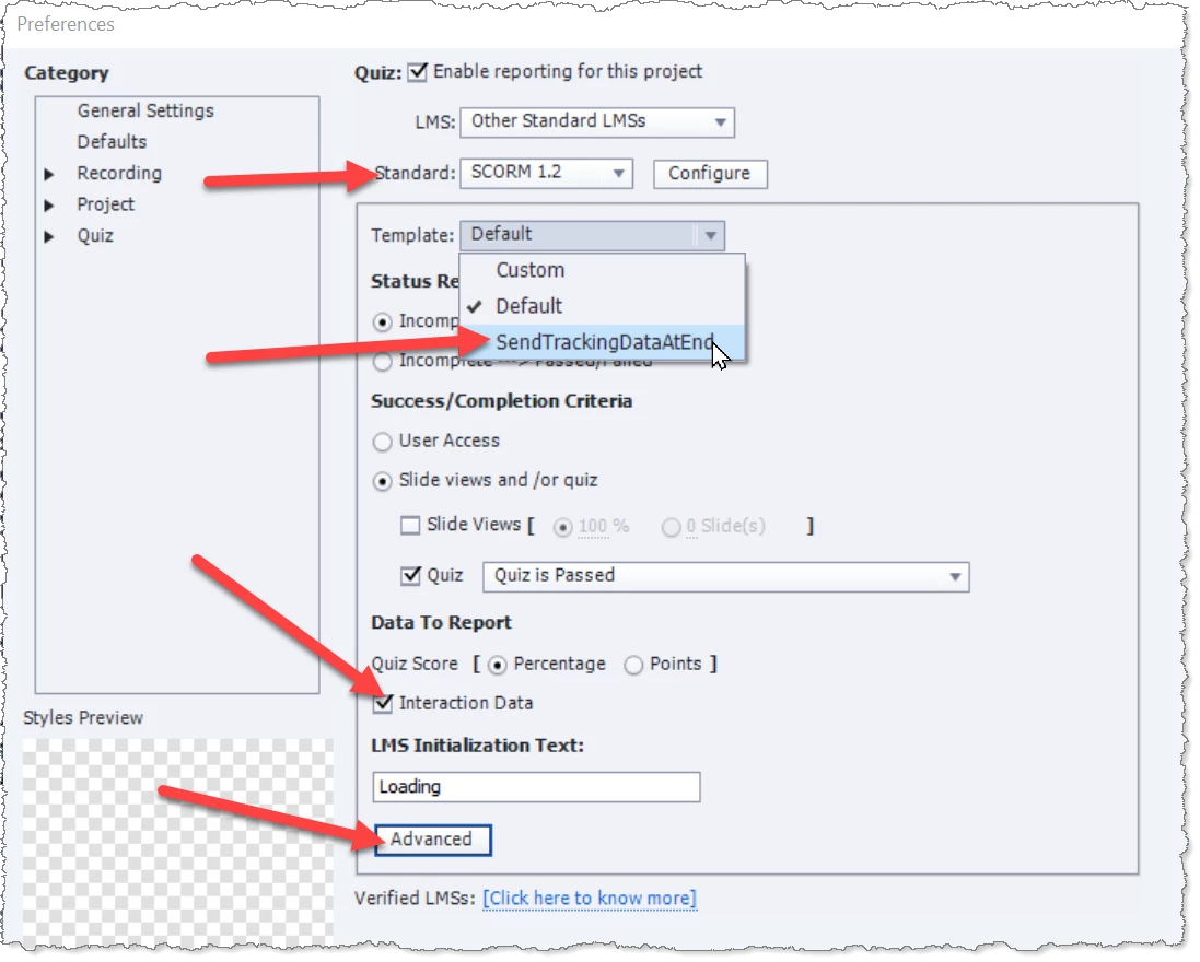

    What you describe of the problem makes me think it is related to the fact that you are using SCORM version 1.2 and you have too much Resume Data from your course bookmarking to send to the LMS.
    When SCORM 1.2 was released, the designers of the standard mistakenly thought that e-learning courses would not be very large.  So they only allowed for a small amount of memory allocated to the Resume Data.  However, course designers very quickly started creating courses with numerous interactions and quiz questions that exceeded the allowed space for the Resume Data.  What happened then was that when learners resumed a large course, some of the interaction data in the LMS would be overwritten by data from the second session.  The solution to this was SCORM 2004 which was designed with much larger memory allocation to allow for huge courses.
    So, the first thing I would test in your case is to change the Quiz settings to be SCORM 2004 and then test the module again in SCORM Cloud.  IF you can confirm that SCORM 2004 would resolve the issue, then you need to find out whether or not your in-house LMS supports that version of SCORM.
    IF it does not, and SCORM 1.2 is the best it can do, there are some other options open to you:
    • One option is to turn off Resume Data Bookmarking and tell all users for this course that they have to complete it in a single session.  No option to leave and return later.
    • You can also try reducing the amount of data being sent to the LMS by de-selecting the checkbox for Interaction Data.
    • Make sure the option under LMS Advanced settings for Send Data on Every Slide is NOT checked.
    • Change the Default Template to the one for SendTrackingDataAtEnd
    IF you do not have the option to go to SCORM 2004 and none of the tweaks suggested above reduce the data sufficiently to resolve the issue, then you may simply need to break your project into smaller modules to fix it.  The issue is usually related to just having too many interaction items reporting to the quiz.

    RodWardCorrect answer
    September 22, 2021
