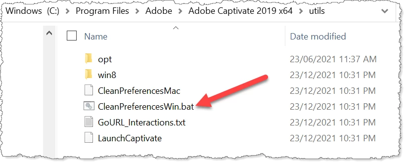

    Those are the files downloaded for you to install Captivate.  If you have already installed Captivate then you need to look inside the folder on your system where Captivate is now installed.  For Captivate 2019 would be something like this:
    C:\Program Files\Adobe\Adobe Captivate 2019 x64\utils
    This is what you should see there:
    You need to double-click the CleanPreferencesWin.bat file to execute it.  However, if you are in a corporate environment, this task may need to be performed by someone from your IT department who has Admin privileges.

    I should mention that this is an extracted zip file that I originally downloaded when we bought the program.
