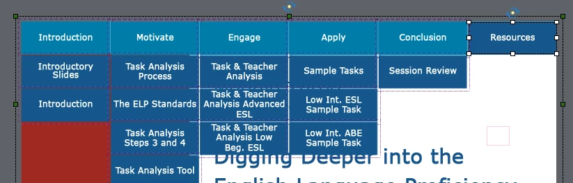

This is the menu fully in the Captivate program - normally the user would only see one of the sub-menus at a time.

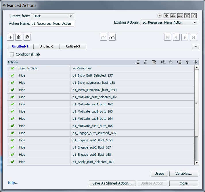

This is an example of the advanced actions of the menu buttons.
Resources button is supposed to be tabbed to after the conclusion sub-menu buttons as shown here:
