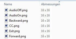

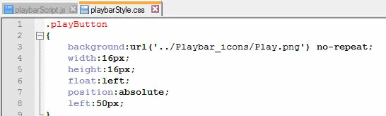

The blur effect is a result of up-/downscaling of the images. In the corresponding css-file you´ll find several sizes, e.g.:
This must be the same size as the images really have:
For the hover effect my playbar uses other images in a different size:
If images size is always the same, there will be no scaling and therefore no blur effect :-)

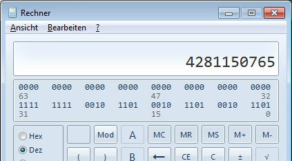

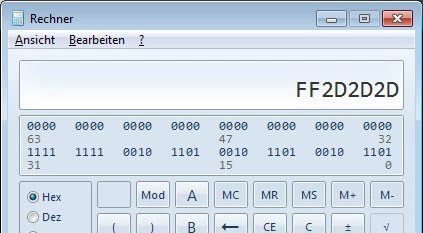

For the numbers in the corresponding .ini-file, such as: PlayBarButtonIconColor=4281150765 I discovered that these are decimal written color codes. To get the HEX-Code just just change it using the calculator:
Note: The first two digits of the HEX code define the alpha (in this example FF=Alpha 255 = no transparency)
