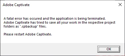

I am working on a project and I have inserted a slide video on a blank slide.
I tried to copy and paste the 'Previous' and 'Next' buttons from the previous slide but I get the fatal error message (see image below).
I was wondering if anyone is able to guide me and shed some light on why this may be happening? Or any other workarounds?
I am using Captivate 2019 Release v11.5.5.553

    Did you clean the Preferences as well? Before reinstalling, would try that also, besides the suggestion of Rod which would figure out if Captivate or the project is corrupted.
    http://blog.lilybiri.com/tips-for-troubleshooting

    I explained 'how' in that blog: find the subfolder 'utils' in the installation folder of Captivate. Run CleanPreferencesWin.bat while CP is closed.

    There may be something wrong with your Captivate installation and reinstalling would fix it.
    However, BEFORE you go to all that trouble, first try quickly creating a new Blank project, insert a video and then try to replicate the behaviour in that new project.  If you can replicate the behaviour in a new project then the issue is unlikely to be corruption in your main project.  It would point to something happening at the system level rather than at the project level.  So reinstalling would then be your next best option.
    If this problem turns out to require a reinstall of Captivate, the issue could be that something else has changed on your system (perhaps an update to Windows or installation of some other app) that is causing the issue.

    I did try your suggestion already and yes, I was able to replicate the same error - so it was comforting to know that the project wasn't corrupted.
    We did have a Windows update and so things are pointing in that direction. I have been speaking with someone from the IT team to see if it was possible to uninstall and reinstall but we came across this:
    They can uninstall my Captivate but they will not be able to reinstall do to the above error message. So someone in software is looking into downloading Captivate again.
