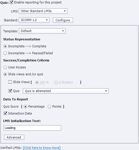

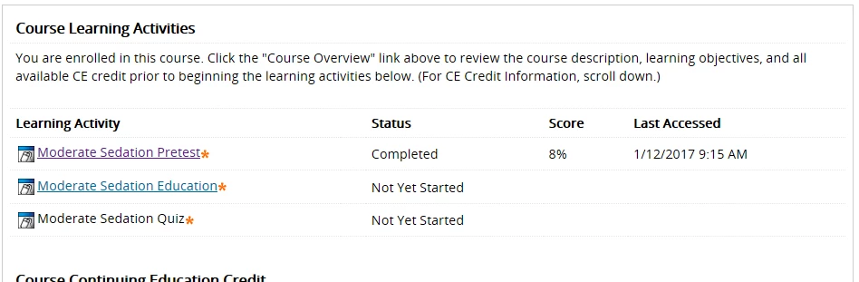

I have been having an issue with using HTML5 for exams. Within the captivate module I can score a 100% but the reported score is 8%. This only happens when publishing to HTML5. Flash publishing works fine. With the big push to move away from Flash this has recently become a big issue. Thanks! Scot

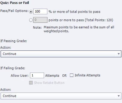

Here are my quiz settings.

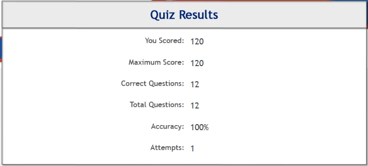

Unfortunately that did not seem to do the trick. I tried changing the point total to equal 100 exactly and then again so it reported less than 100 points. Neither seemed to have an effect.
The funny thing is that the score that reports seems to be the equivalent of one question regardless of the actual score achieved in the module. I completed the exam twice and received a 100% and 40%. When I had 12 questions it was consistently scoring 8% (1 of 12).Once I removed 2 questions the score kept returning 10%

Here is a screenshot from the advanced interaction window.
