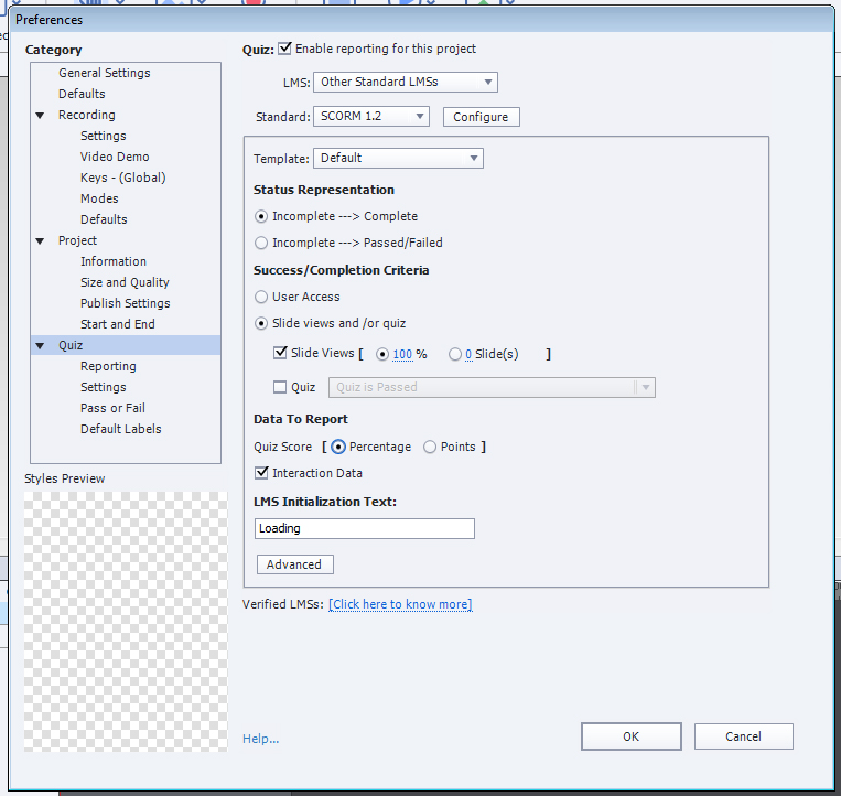

I have a basic practice quiz setup, using SCORM 1.2.
== Description ============================================
10 questions
10 slides + a results slide
Advanced Action validates a drop-down widget choice
If widget = correct {
quiz score is incremented from it's initial value of "0"
I then divide total questions / correct answers to get a score, which i called "my_result".
...which i would then like to submit to the LMS in place of Captivate's native quizzing.. if possible that is.   :-)
== Question ============================================
Your comment above said the native quiz values are read-only.
Any chance we could get around the read-only-ness via JavaScript?
Thank you for your thoughts!
~ Sean
One of the advanced actions in Cap -->>
